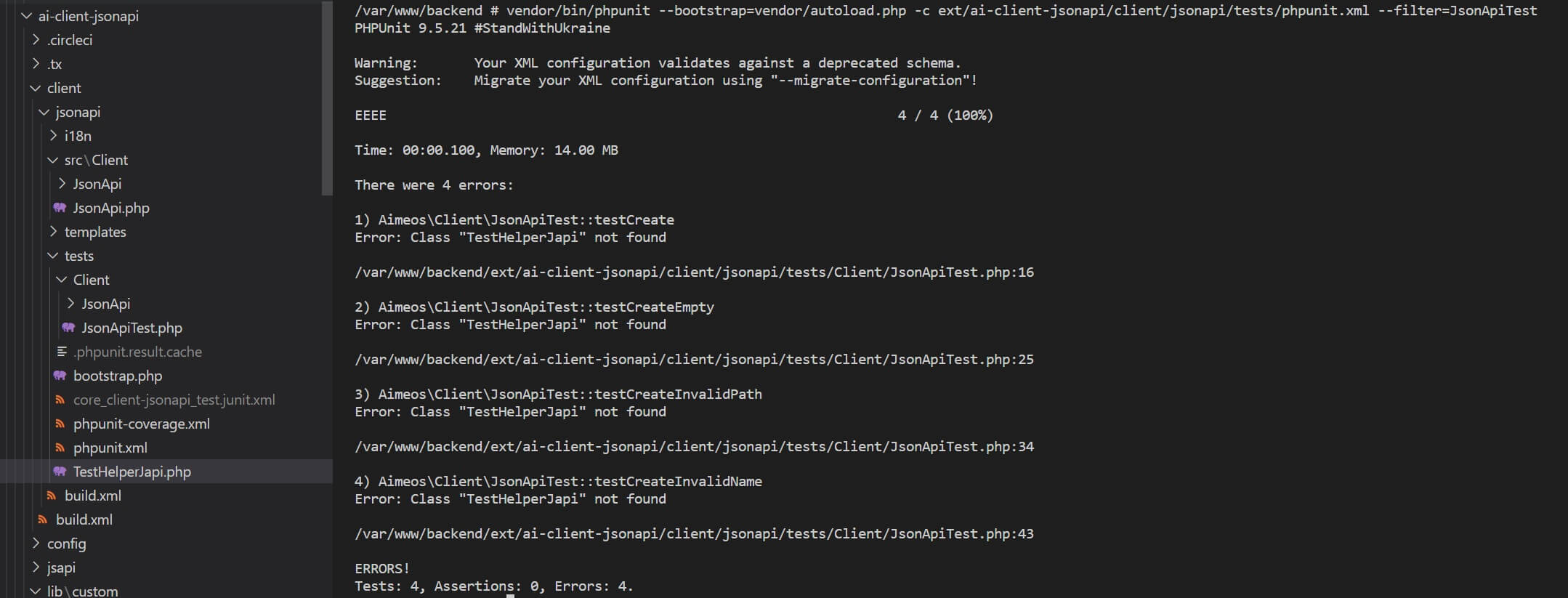

I am using laravel 6.x, PHP 7.4, Docker desktop/Ubuntu and the Aimeos 2021 (aimeos-laravel: 2021.10.4 / aimeos-core: 2021.10.13)
I would like to ask how to use the unit test in the ext. We have successfully used the ext modified code and now with our modifications we would like to use the unit test built-in to it. I have found some of the convo using it like the code below but seems like it is not properly working. Kindly help how to use it?
vendor/bin/phpunit --bootstrap=vendor/autoload.php -c ext/ai-client-jsonapi/client/jsonapi/tests/phpunit.xml --filter=JsonApiTest
Re: Using ext unit test
Post by aimeos » 08 Jul 2022, 08:48
Running tests for extensions in a Laravel environment is a bit tricky.
Even if you run it that way, there's no access to the database so the tests fail:
vendor/bin/phpunit --prepend vendor/autoload.php --include-path vendor/aimeos/aimeos-core/ -c vendor/aimeos/ai-client-html/tests/phpunit.xml
What's always working is to check out aimeos/aimeos-core separately and place your extension (or link to it) in its ./ext/ folder. This is described here:
https://aimeos.org/docs/latest/develope ... sion-tests

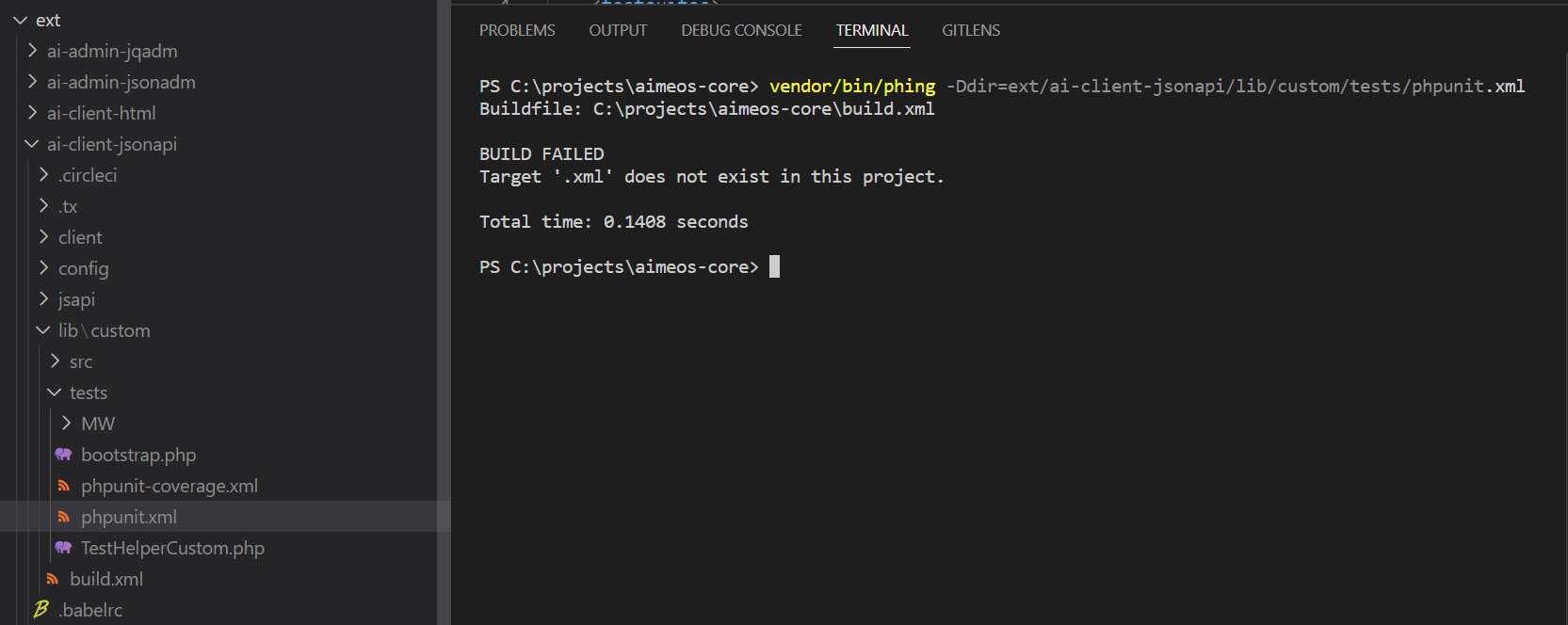

I have clone the aimeos core in a separate project for testing and I have successfully executed vendor/bin/phing setup from the instruction in the documentation but I am having trouble to test the ext folder unit test files. I can even test the buit-in unit test of the core with this command.
vendor/bin/phpunit --bootstrap=vendor/autoload.php -c tests/phpunit.xml
But for ext folder unit test with these command are having some issues. I don't how to make it work, kindly help?
vendor/bin/phing -Ddir=ext/ai-client-jsonapi/client/jsonapi/tests/phpunit.xml
vendor/bin/phing -Ddir=ext/ai-client-jsonapi/lib/custom/tests/phpunit.xml
Post by aimeos » 12 Jul 2022, 06:16
IvanIgniter wrote: 11 Jul 2022, 10:43 vendor/bin/phing -Ddir=ext/ai-client-jsonapi/client/jsonapi/tests/phpunit.xml
The correct command is:
vendor/bin/phing -Ddir=ext/ai-client-jsonapi testext

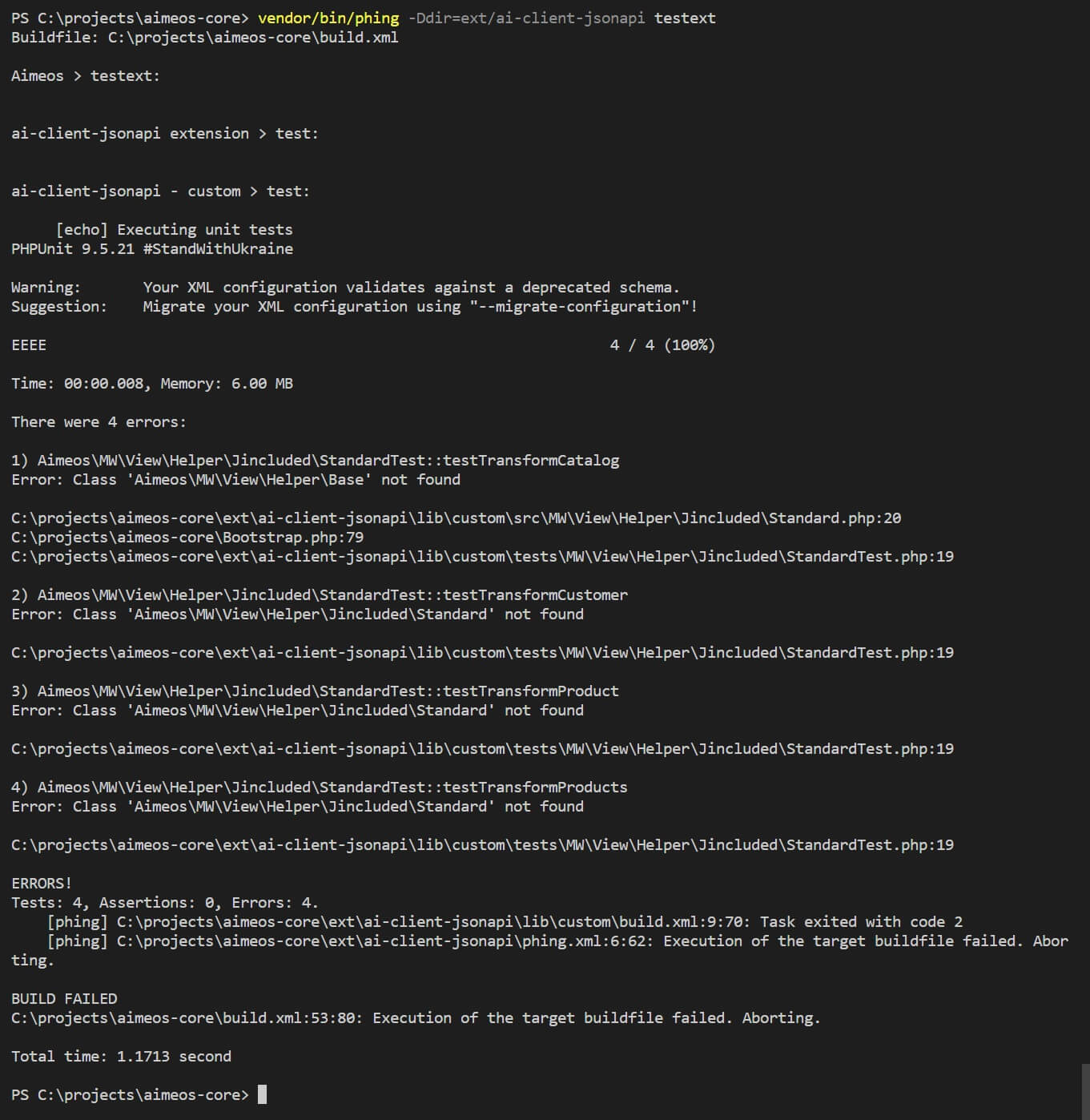

IvanIgniter
Posts: 58
Joined: 01 Dec 2021, 07:41
Post by IvanIgniter » 12 Jul 2022, 10:07
It did able to execute but still has an issue with it's default standard test. Any idea it cannot find the following class?
Post by aimeos » 13 Jul 2022, 11:42
Did you run "composer up" to install all dependencies?
Post by IvanIgniter » 15 Jul 2022, 01:37
Yes I did. I clone the aimeos-core: 2021.10 and copied our modified ext folder into the new project.
Phing seems to be working but it was not able to find 'Aimeos\MW\View\Standard' class upon initializing?
Post by aimeos » 17 Jul 2022, 06:43
You must not modify the Aimeos extension code directly because you won't be able to update and get bugfixes and security patches any more! Instead, only overwrite those files/classes you really need to change to get the behavior you want!
Can you please post the output of "composer show" for your Aimeos Core checkout?

Post by IvanIgniter » 18 Jul 2022, 07:03
We only modify parts of the code that are necessary for display of records and how it looks.
I clone the aimeos core https://github.com/aimeos/aimeos-core/tree/2021.10
This is the result of composer show:
Post by aimeos » 19 Jul 2022, 08:06
You've checked out the master branch of aimeos/aimeos-core but you need the branch that matches your extension version (2021.10).
