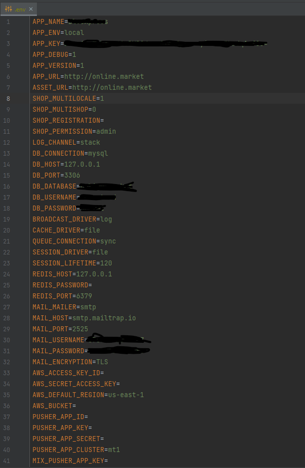

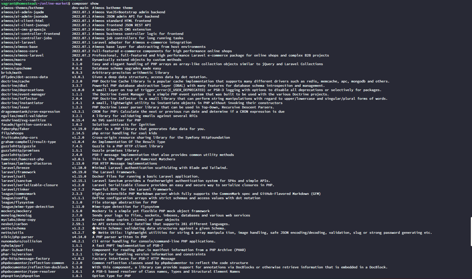

Can you please post the output of "composer show" and your .env file (without the credentials)?peter69 wrote: 07 Jul 2022, 20:45 the problem also appears in the checkout process:

Re: Route [aimeos_home] not defined.
Hello Sir,
I share with you the requested screenshots.
Now I only get an error "A non-recoverable error occurred" in the checkout process that does not allow me to finalize the purchase.
Regards,
Regards,
