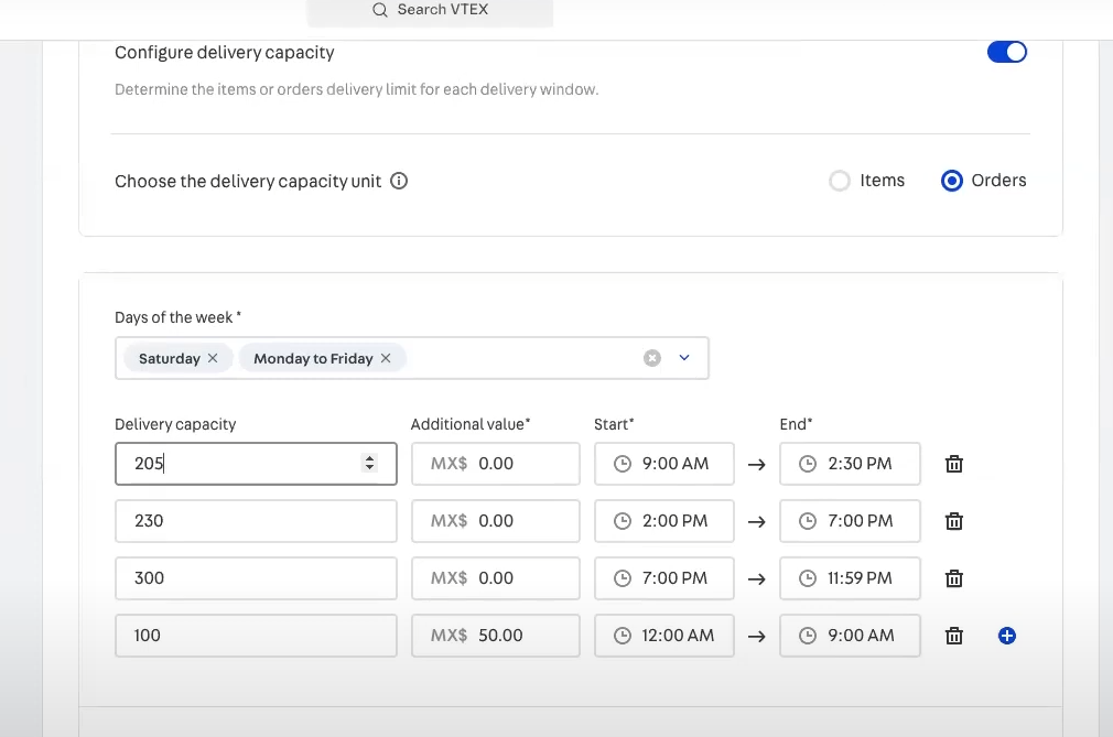

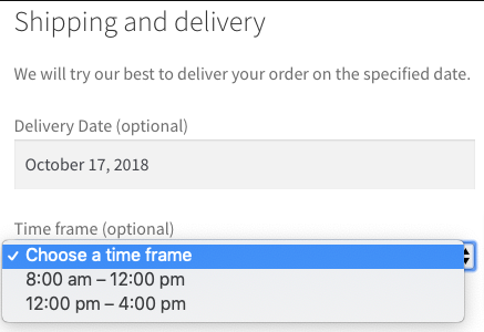

I did the test with what you indicated, however it is not exactly what I need.
What we need is for the customer to be able to choose ranges of hours available to receive delivery (these ranges of hours must be previously configured/enabled beforehand by the administrator):
Also for ensuring that the store can process all orders by limiting the number of orders per day or per time period.
Attached is a demo image,
Again, thank you very much for any help you can give me.
Best regards!

- wc-od-checkout-time-frame.png (57.48 KiB) Viewed 36755 times

Hello Sir,
I keep trying to implement this feature, but I have not been able to do it yet. I am not sure what is the correct/recommended way to do it.
The idea is to define "Time slots" and in each time slot to be able to define a "delivery capacity". Then in the frontend disable the time slots that have reached the "delivery capacity".
Each slot must have as configuration: delivery capacity, start time and end time.
I have tried to add the functionality of the time slots with a decorator as you indicated, but however in the configuration part only allows option and value.
I would be very grateful if you could guide me or give me suggestions on how to implement these features,
Attached is an image of the features I wish to implement.
Thank you very much for your time and for the help you can give me,
Best regards!

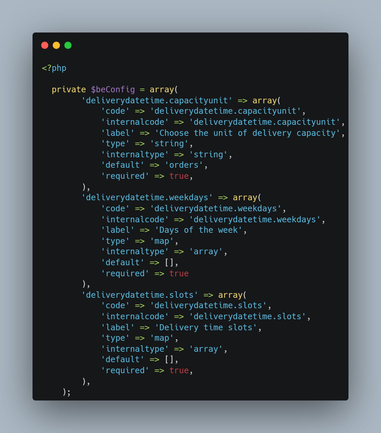

Re: Delivery Pickup Date and Time
Hello!
So it means that in the decorator the configuration must be defined as follows?:
Also, the "slot" that the customer chooses will be saved in the order?
If so, then is it possible to disable a time slot in case it has reached the delivery capacity limit via ?
Thank you very much for your kind help,
Best regards!
private $beConfig = array(
'delivery.slots' => array(
'code' => 'delivery.slots',
'internalcode' => 'delivery.slots',
'label' => 'Delivery time slots',
'type' => 'map',
'internaltype' => 'array',
'default' => [],
'required' => false,
$manager->search();Thank you very much for your kind help,
Best regards!
This would allow you to enter something like this in the existing config section of the service backend:peter69 wrote: 12 Nov 2022, 06:21Code: Select all
private $beConfig = array( 'delivery.slots' => array( 'code' => 'delivery.slots', // ... ), );
delivivery.slots => [
'capacity' => 100,
'begin' => '09:00',
'end' => '14:30',
By default, only a key and value is stored in the mshop_order_base_service_attr table but in your decorator, you can also set more complex values as JSON encoded string using th setAttributes() method:peter69 wrote: 12 Nov 2022, 06:21 Also, the "slot" that the customer chooses will be saved in the order?
https://aimeos.org/docs/latest/provider ... store-data
Yes, the getConfigFE() method returns what is shown in the frontend. You can filter what's not available any more in that method.peter69 wrote: 12 Nov 2022, 06:21 If so, then is it possible to disable a time slot in case it has reached the delivery capacity limit via?Code: Select all
$manager->search();

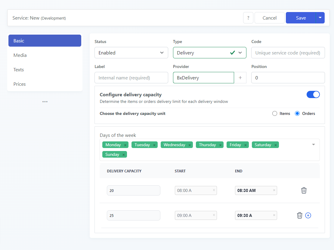

Hello aimeos,
I have already added the vue component that displays the time slots. Now I would like to know what is the name I should give to the input where the JSON containing the time slots is saved.
I know that the configurations consist of key and value, but in this case how should I name the input to save the configurations?
Regards,
Regards,
I attach a screenshot where you can see the component I have created and also the settings I have configured in my delivery service provider.
I know that the configurations are saved as key/value, but I don't know what names I should give to the inputs so that they are saved correctly.
- service-delivey-capacity-custom-config.png (99.08 KiB) Viewed 36476 times
- service delivery config-min.png (77.04 KiB) Viewed 36476 times
