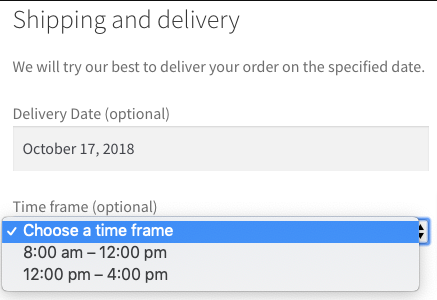

What we need is for the customer to be able to choose ranges of hours available to receive delivery (these ranges of hours must be previously configured/enabled beforehand by the administrator):
wc-od-checkout-time-frame-png-446×305- (1).png (57.48 KiB) Viewed 27633 times
Also for ensuring that the store can process all orders by limiting the number of orders per day or per time period.
Attached is a demo image,
Again, thank you very much for any help you can give me.
