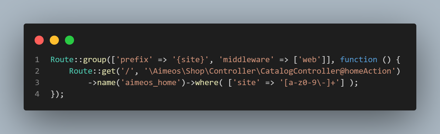

this is my routes in config/shop.php and routes/web.php

What's the content of your routes/web.php file?

Post by VirtualSpy » 13 Oct 2022, 11:14
aimeos wrote: 13 Oct 2022, 09:39 What's the content of your routes/web.php file?
<?php
use Illuminate\Http\Request;
use Illuminate\Support\Facades\Route;
use Illuminate\Support\Facades\Storage;
use App\Http\Controllers\tmp_order;
| Web Routes
| Here is where you can register web routes for your application. These
| routes are loaded by the RouteServiceProvider within a group which
| contains the "web" middleware group. Now create something great!
//Test
//  Test ""
$params = [];
$conf = ['prefix' => '', 'where' => []];
Route::any("business_api_order_callback", function (Request $value) {
    $request = json_encode($_REQUEST);
    $rawdata = file_get_contents("php://input");
    $filename = rand(1, 1000) . ".txt";
    $folder_name = "order_confirmation";
    if ($value->input('source') == "ship_notification") {
        $folder_name = "ship_notification";
    file_put_contents("$folder_name/$filename", $request . $rawdata);
Route::any('order_conformation/callback', function () {
    //   $data =file_get_contents('./order_confirmation/158.txt');
    $val =  glob("./order_confirmation/*");
    foreach ($val as $data) {
        $result = file_get_contents($data);
        print_r ("<br>".$result ."<br>");
Route::any('ship_notification/callback', function () {
    // $data = file_get_contents('./ship_notification/581.txt');
    $val =  glob("./ship_notification/*");
        print_r("<br>" . $result . "<br>");
Route::any("test", function () {
    dd(public_path() . " <- public path - base_path ->  " . base_path());
if (env('SHOP_MULTILOCALE')) {
    $conf['prefix'] .= '{locale}';
    $conf['where']['locale'] = '[a-z]{2}(\_[A-Z]{2})?';
    $params = ['locale' => app()->getLocale()];
    Route::get('/admin', function () use ($params) {
        return redirect(airoute('aimeos_shop_admin', $params));
if (env('SHOP_MULTISHOP')) {
    $conf['prefix'] .= '/{site}';
    $conf['where']['site'] = '[A-Za-z0-9\.\-]+';
if ($conf['prefix']) {
    Route::get('/', function () use ($params) {
        return redirect(airoute('aimeos_home', $params));
Route::group($conf ?? [], function () {
    require __DIR__ . '/auth.php';
Route::group(['prefix' => '{site}', 'middleware' => ['web']], function () {
    Route::get('/', '\Aimeos\Shop\Controller\CatalogController@homeAction')
        ->name('aimeos_home')->where( ['site' => '[a-z0-9\-]+'] );
Route::get('tmp_order','App\Http\Controllers\tmp_order@index',);
Route::get('tmp_order/xml/{id}','App\Http\Controllers\tmp_order@xml')->name('tmp_order/xml');

Try to remove lines from your routes/web.php file until it works with cached routes too.
This way you may find out what the problem is.
