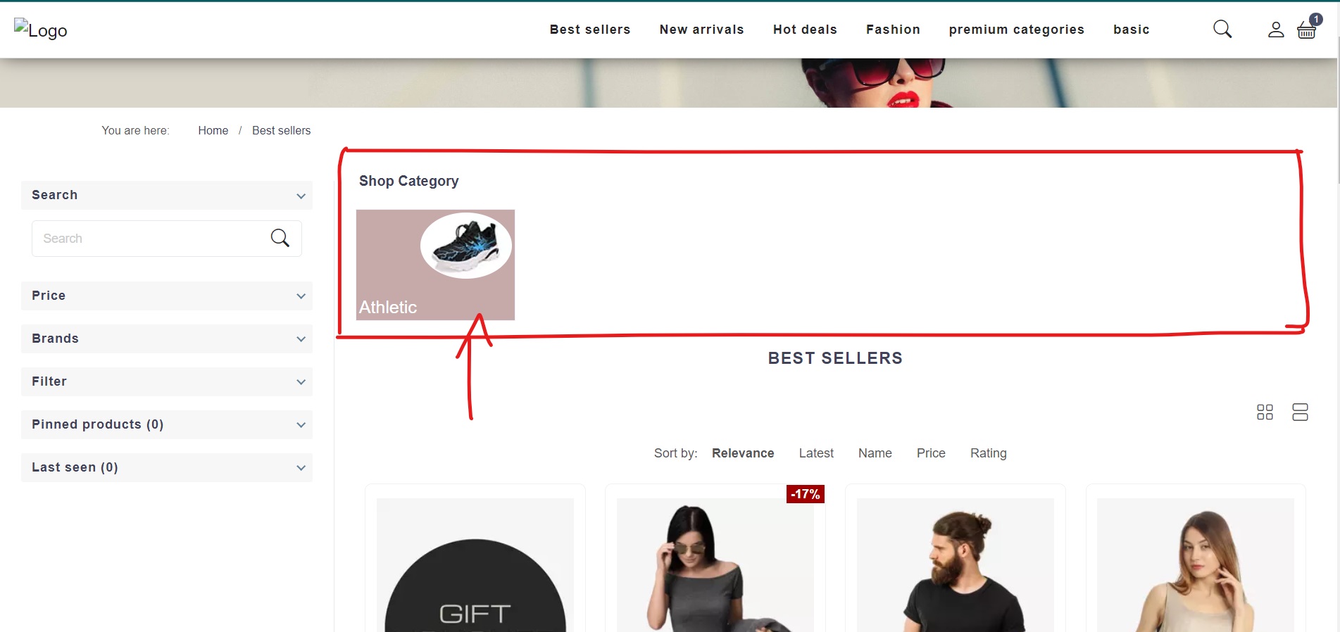

I wanted to show the next child categories lists of parent categories in the catalog List page when the parent category is active in catalog List page .............
please explain to me with steps to fulfill this ...
for checking, I am uploading an image ...
Thanks in advance ...

You can use code similar to this one.
The first is a decorator for the catalog list component you have to place in ./src/Client/Html/Common/Decorator/ directory:
<?php
namespace Aimeos\Client\Html\Common\Decorator;
class ListCategories
	extends \Aimeos\Client\Html\Common\Decorator\Base
	implements \Aimeos\Client\Html\Common\Decorator\Iface
	public function addData( \Aimeos\Base\View\Iface $view, array &$tags = array(), string &$expire = null ) : \Aimeos\Base\View\Iface
		$view = parent::addData( $view, $tags, $expire );
		$view->listNode = \Aimeos\Controller\Frontend::create( $this->context(), 'catalog' )
			->uses( ['media', 'text'] )->root( $view->param( 'f_catid' ) )
			->getTree( \Aimeos\Controller\Frontend\Catalog\Iface::LIST );
		return $view;
Then, you have to configure the decorator in the ./config/client.php file of your extension:
    'html' => [
        'catalog' => [
            'lists' => [
                'decorators' => [
                    'global' => ['ListCategories']
Finally, render the categories in the catalog/list/body.php template.
<?php if( isset( $this->listNode ) ) : ?>
        <?php foreach( $this->listNode->getChildren() as $item ) : ?>
                <a class="cat-item" href="<?= $enc->attr( $this->url( ( $item->getTarget() ?: $target ), $controller, $action, $params, [], $config ) ); ?>">
                        <?php if( $mediaItem = $item->getRefItems( 'media', 'default', 'default' )->first() ) : ?>
                                <img src="<?= $enc->attr( $mediaItem->getPreview() ) ?>" >
                        <?php endif ?>
                        <span class="cat-name"><?= $enc->html( $item->getName(), $enc::TRUST ); ?></span>
                </a>
        <?php endforeach; ?>
<?php endif ?>
