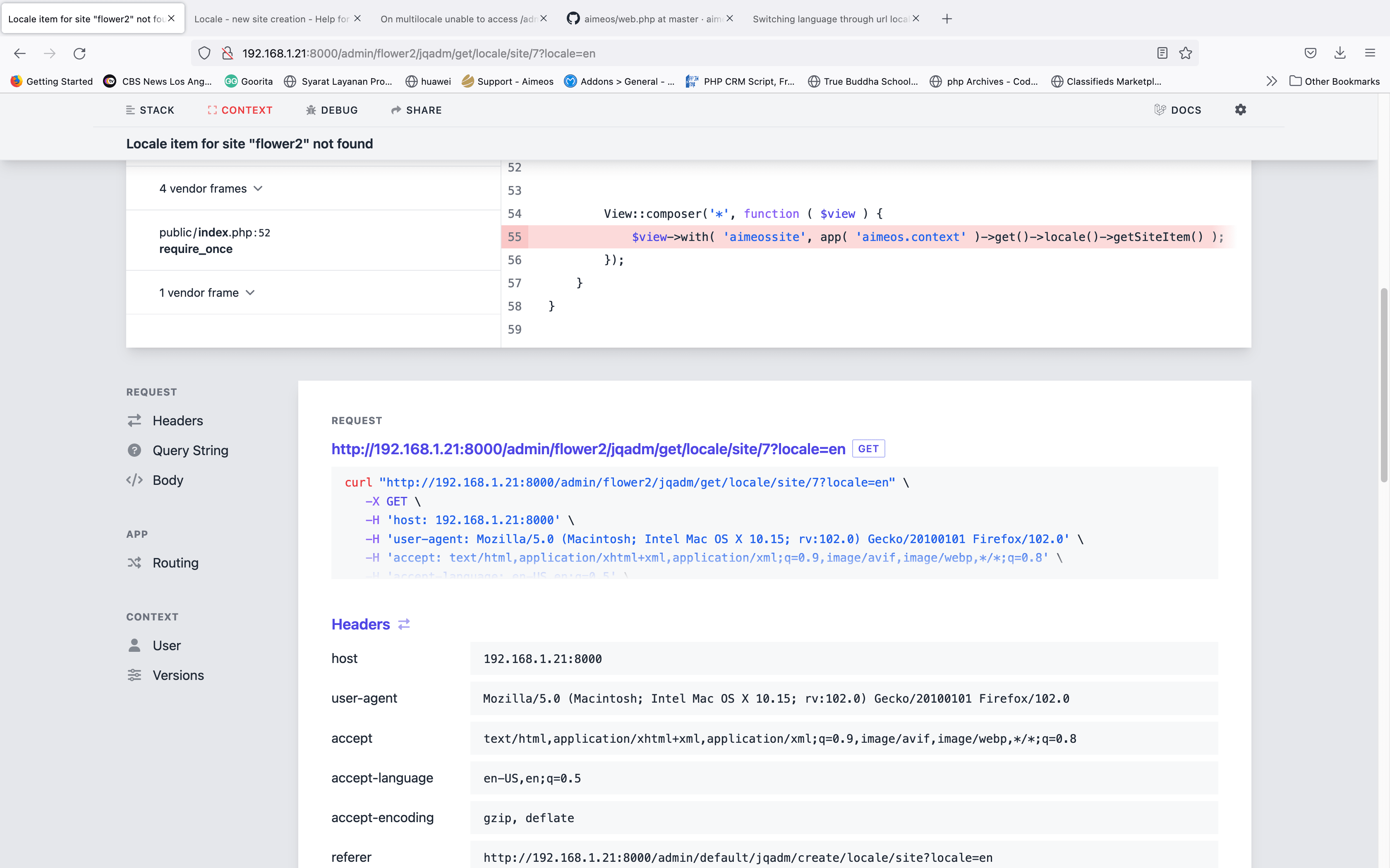

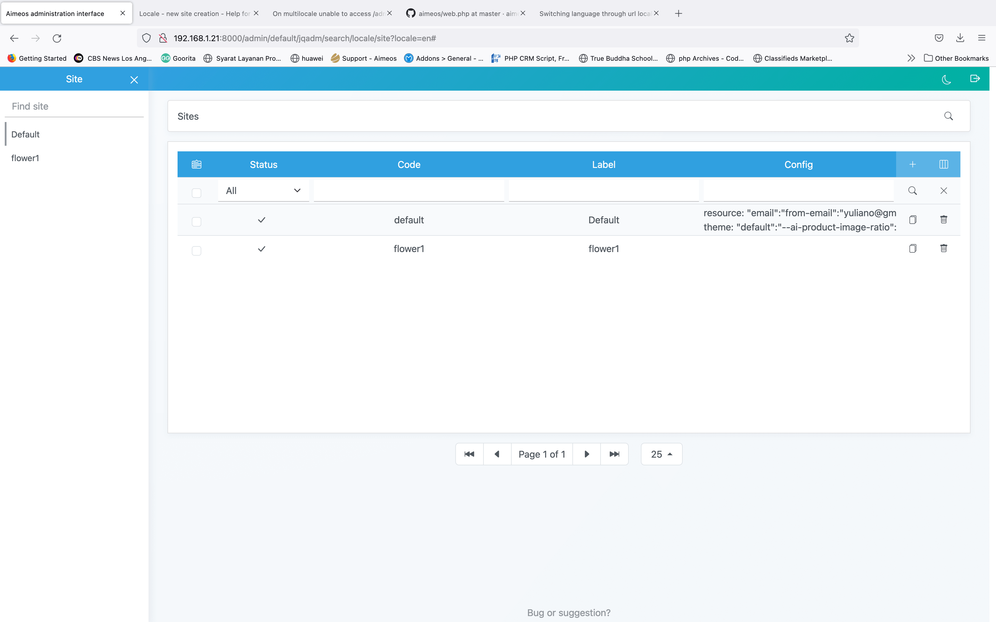

I want to ask you guys, I just installed aimeos and try to learn about creating vendor from Admin > Locale > site
but i got this error
App \ Providers \ AppServiceProvider : 55
App\Providers\{closure}
View::composer('*', function ( $view ) {
$view->with( 'aimeossite', app( 'aimeos.context' )->get()->locale()->getSiteItem() );
Did anyone have this problem too?
did I do wrong in installation?
thanks for any inputs.
Mike

thanks for the reply,
the setup is on Centos 7 machine and
Php Version 8.1.13
Laravel Version 9.44.0
Laravel Locale en
Laravel Config Cached false
App Debug true
do you have any sugestion on what is the best machine aimeos can run? should i use ubuntu like in your youtube demo videos?
thank you so much.
best,
mike

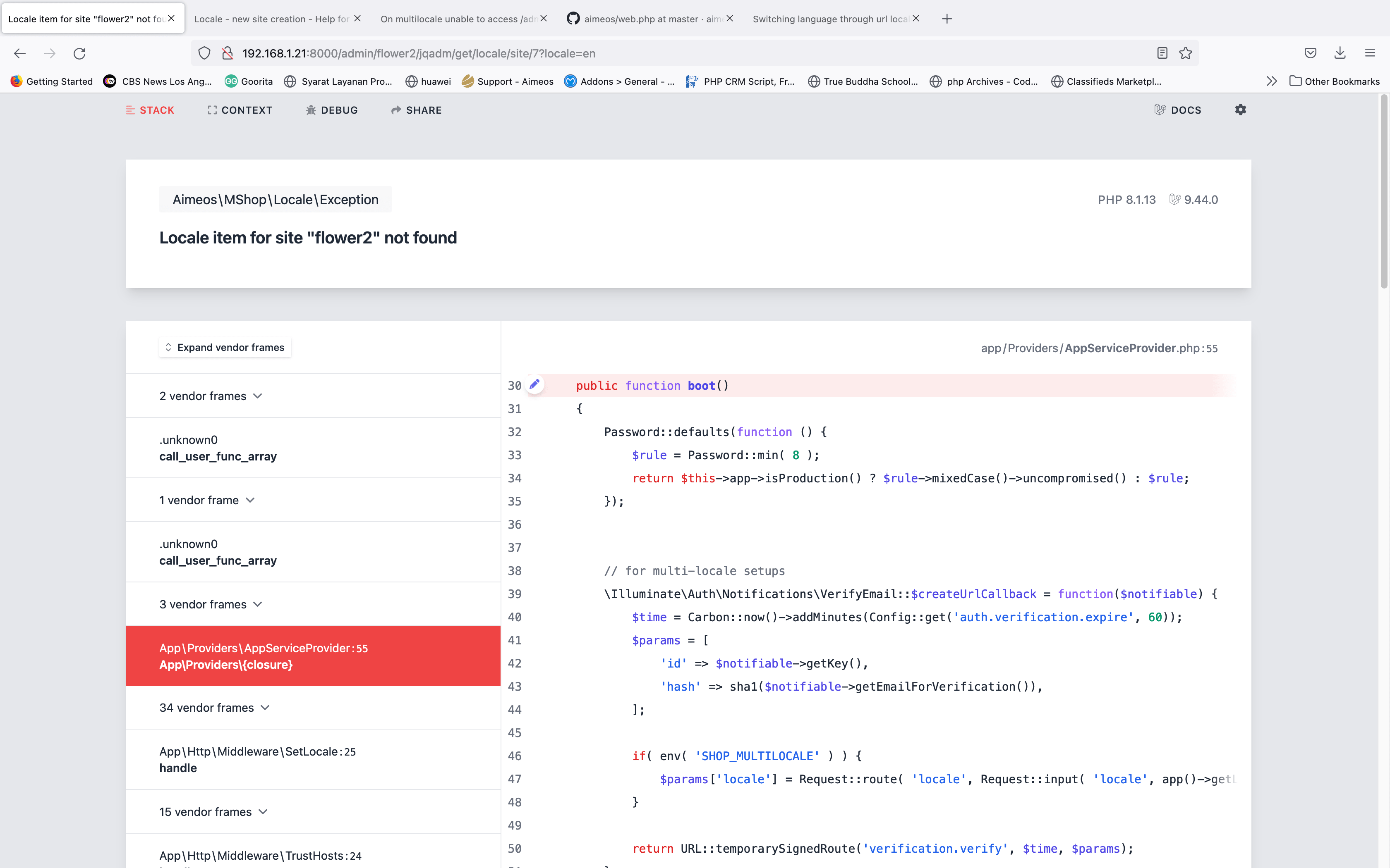

and the error on this part
public function boot()
Password::defaults(function () {
$rule = Password::min( 8 );
return $this->app->isProduction() ? $rule->mixedCase()->uncompromised() : $rule;
// for multi-locale setups
\Illuminate\Auth\Notifications\VerifyEmail::$createUrlCallback = function($notifiable) {
$time = Carbon::now()->addMinutes(Config::get('auth.verification.expire', 60));
$params = [
'id' => $notifiable->getKey(),
'hash' => sha1($notifiable->getEmailForVerification()),
if( env( 'SHOP_MULTILOCALE' ) ) {
$params['locale'] = Request::route( 'locale', Request::input( 'locale', app()->getLocale() ) );
return URL::temporarySignedRoute('verification.verify', $time, $params);

Re: Locale - new site creation
Did you rename the "default" site or create a new site?
Can you record a screencast so we know what you are doing?
The Linux distribution is pretty irrelevant for Aimeos as long as PHP and its extensions are installed.

Hi. thanks for the quick reply . these are the screen shots. it happens when in Default admin site and try to create new vendor ...thru locale and then site. and no I didn't try to change the default name
![Image]()
- Screen Shot 2022-12-23 at 09.44.24.png (164.89 KiB) Viewed 9085 times
- Screen Shot 2022-12-23 at 09.44.42.png (161.15 KiB) Viewed 9085 times
- Screen Shot 2022-12-23 at 09.44.15.png (168.44 KiB) Viewed 9085 times
- Screen Shot 2022-12-23 at 09.43.40.png (231.06 KiB) Viewed 9085 times
We've found the problem. First, you have to run:
Then, you need to adapt the ./app/Providers/AppServiceProvider.php file in your installation:
composer req aimeos/aimeos-laravel:2022.10.x-devCode: Select all
try {
} catch( \Exception $e ) {
$view->with( 'aimeossite', \Aimeos\MShop::create( app( 'aimeos.context' )->get( false ), 'locale/site' )->create() );
mikeberlin
