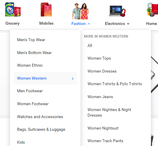

laravel version 9.36.4 , Aimeos version 2022.10.3 and PHP version 8.1.3 (Win)
i want to hover subcategories on right side menu ...... i have attached an example ........please guide me for this task
Thanks in advance

You need to adapt the HTML/CSS and maybe the JS for the catalog/tree component

aimeos wrote: 28 Dec 2022, 20:50 You need to adapt the HTML/CSS and maybe the JS for the catalog/tree component
can you tell me how to get child categories of level 2 category?
Re: hover subcategories on right side
Post by aimeos » 30 Dec 2022, 19:19
Use the getChildren() method of the catalog items and getLevel() to see at which level the catalog item is in the category tree. The catalog/filter tree partial contains all the code for reference:
https://github.com/aimeos/ai-client-htm ... artial.php
