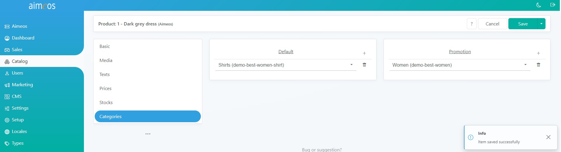

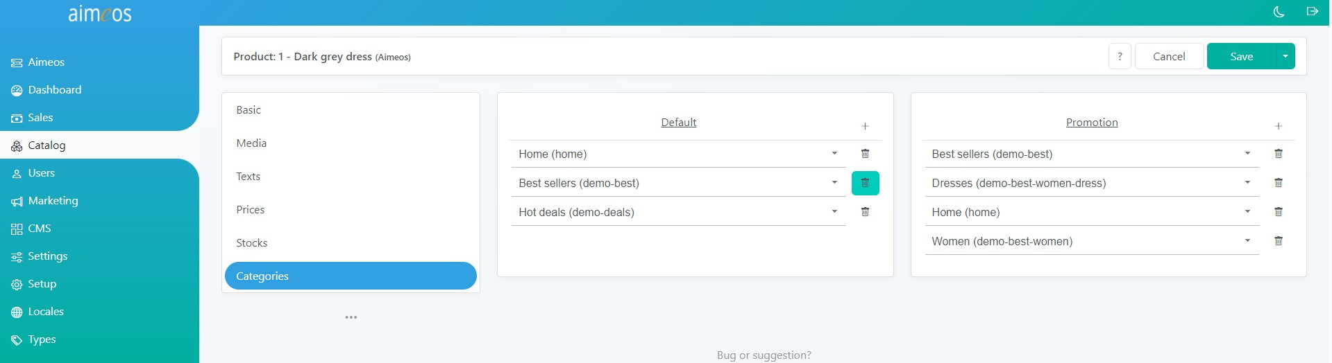

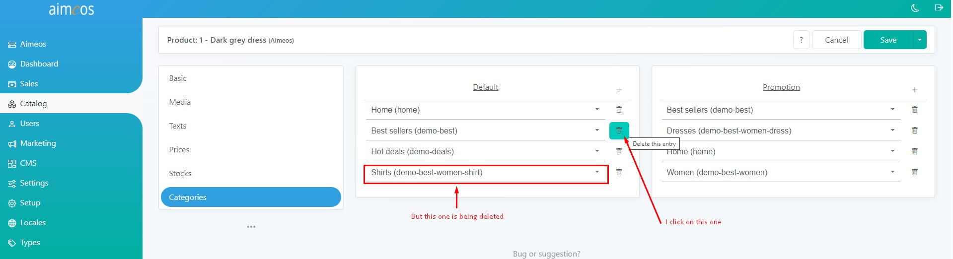

When I want to add multiple categories to the products, I select the categories and save them(1), but only the last one I selected is saved(2). Also when I want to delete one of the selected categories, I click the button next to the category(3) but it always deletes the last category(4). I have the same problem with suppliers. How can I fix this? Thank you.

We can see that behavior in the demo setup too and it may be related to the VueJS code. We will investigate and try to find a solution as soon as possible.
Re: Adding multiple categories to products.
Post by aimeos » 27 Jul 2023, 07:10
Fixed the problem of adding new categories/suppliers and a new release of the aimeos/ai-admin-jqadm package (2023.07.4) is available now. Run "composer up" to install that package.
Regarding removal of existing categories/suppliers, this is a visual problem only because the categories/suppliers you want to remove are actually deleted. Only the label in the drop-down is wrong until you save. This seems to be a problem of the combobox implementation and we will get rid of that by switching to another VueJS component (already in progress).
