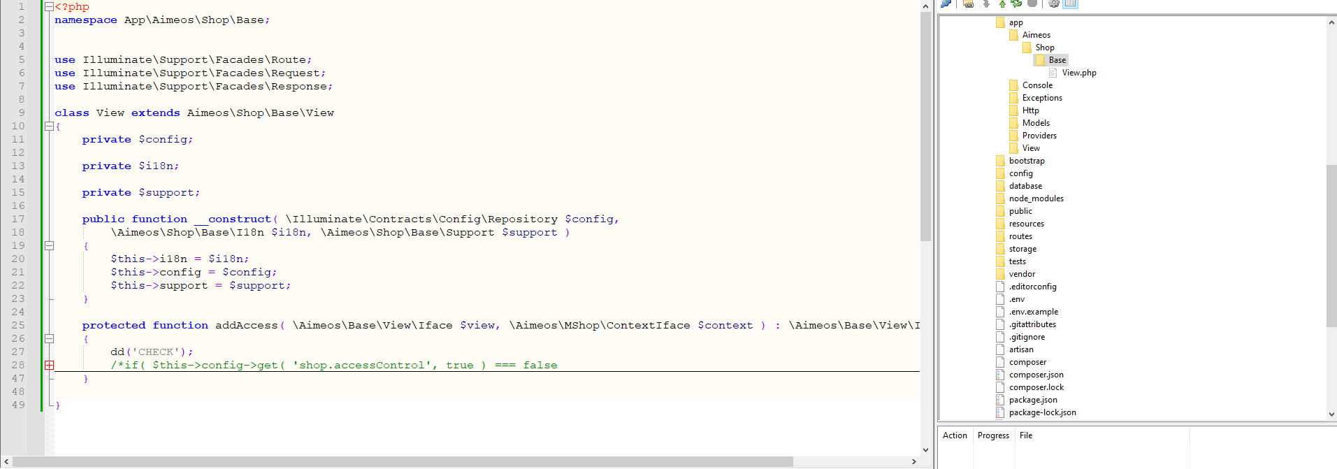

So as not to spoil the core! I want to inherit! Where do I need to place the file in the app folder? I understand I need to do extensionsaimeos wrote: 02 Oct 2023, 12:51 Authorization is done by the access view helper and you can create your own class which queries external authorization sources:

- doc_2023-10-16_09-23-07.png (82.8 KiB) Viewed 27670 times
Re: External administrator or editor authorization
The directory structure must match the PHP namespace of the class so it should be OK. Run "composer dump-autoload" to update the composer files in the vendor directory so it knows the new class.
