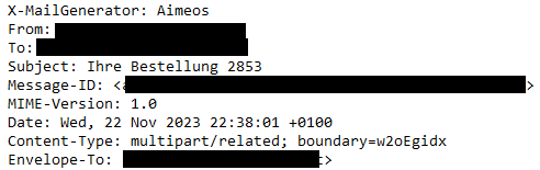

I have double checked my settings and everything seems to be fine.
in .env MAIL_FROM_NAME='My company' is set, also in mail.php
FROM-NAME is still missing in payment mail source:
Screenshot 2023-11-22 230057.png (8.84 KiB) Viewed 9964 times
Re: How to set mail from-name?
Post by aimeos » 24 Nov 2023, 07:11
The name is handed over but it may be that the Symfony mailer component doesn't use it:
https://github.com/aimeos/ai-controller ... il.php#L98
