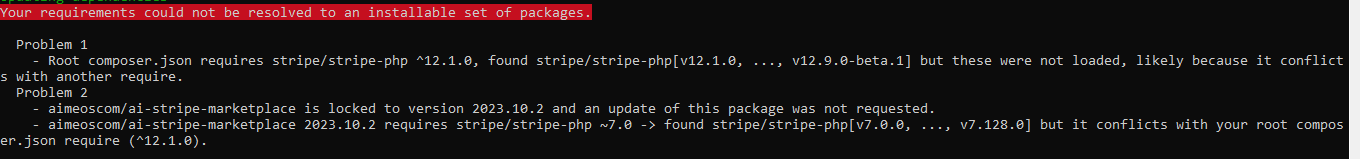

Hi, I am trying to use the Stripe Onboarding using embedded method. But I got this error
Undefined property: Stripe\\Service\\CoreServiceFactory::$accountSessions
On checking with Stripe support, they suggested to use Stripe Version 12.1.0. When I tried to update the stripe, I was getting this error. What can I do to make this working?

I tried to run composer up but it also didnt update anything. Showed no changes. Any suggestions?
