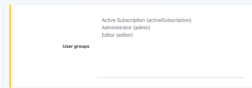

 User groups can be viewed and managed in Users > Customers detail panel.
All I see in the details view for each user is a list of all existing groups:
Screenshot 2024-06-07 at 18.58.50.png (22.5 KiB) Viewed 119277 times
In this case I did not add this user to any of these groups

mrkepzie wrote: 07 Jun 2024, 17:00
None of the groups is selected, so no one is assigned to the user. Managing groups is only allowed by admins and super users.
