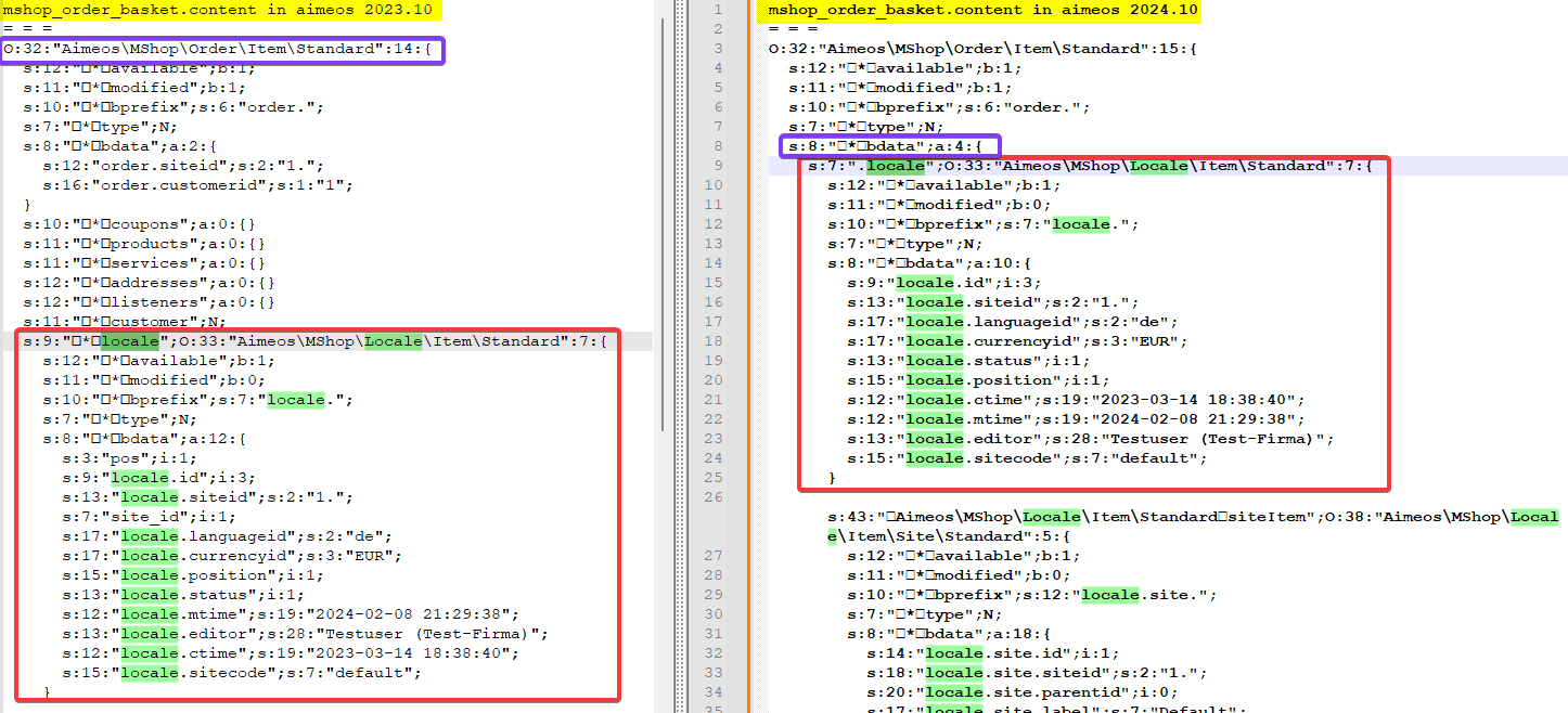

I made a comparison of both (2023.10 and 2024.10) mshop_order_basket.content.
From my point of view all local-data are present, but the structure is different
in 2023: * locale and child of O:32:"Aimeos\MShop\Order\Item\Standard"
in 2024: .locale, child of s:8:" * bdata"
Could this be the cause and how / where can I solve this?
