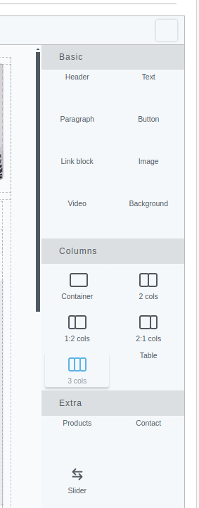

Hello everyone,
I have a problem with icons in the CMS; they suddenly disappeared. Everything was working fine, and now they are not visible in the block editor.
The image is attached.
Linux
Aimeos 2024.10
Hello everyone,
- Screenshot from 2024-11-25 12-15-24.png (22.68 KiB) Viewed 57662 times
Re: Problem with icons in cms editor
This has been fixed by this commit: https://github.com/aimeos/aimeos-larave ... 774d98a786
The fix hasn't been released yet but if you execute this, you will get the fixed package:
composer req aimeos/aimeos-laravel:2024.10.x-devProfessional support and custom implementation are available at Aimeos.com
