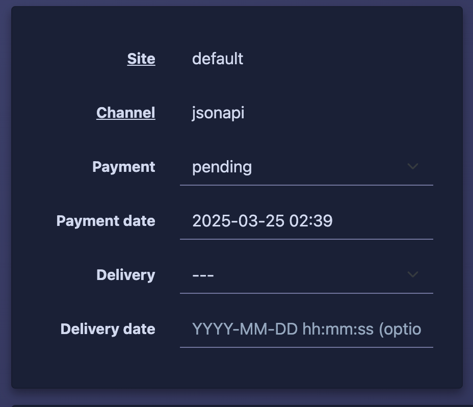

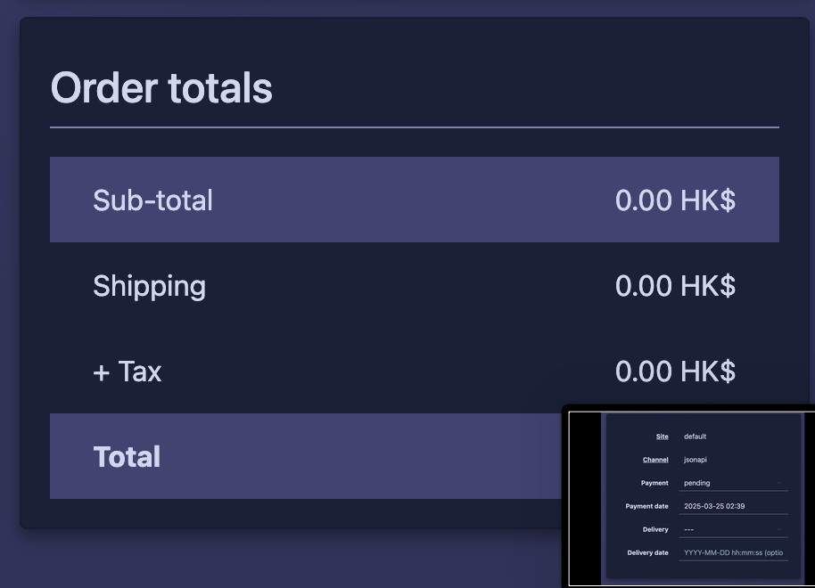

Post by bar_on » 24 Mar 2025, 18:47
Order price is still set to 0 after this change.
This is the payment status and order total before payment intent was created (custom controller).
Screenshot 2025-03-24 at 11.38.58 AM.png (57.69 KiB) Viewed 47457 times
Screenshot 2025-03-24 at 11.38.45 AM.png (104.37 KiB) Viewed 47457 times
This is after the payment intent was created.
Screenshot 2025-03-24 at 11.39.51 AM.png (97.37 KiB) Viewed 47457 times
Screenshot 2025-03-24 at 11.39.55 AM.png (85.37 KiB) Viewed 47457 times
The problem doesn't happen if I manually change the payment status in jqadm platform, but when I call
$order->setStatusPayment(4);
$manager->save($order);
in backend,
all the prices will be set to 0.
