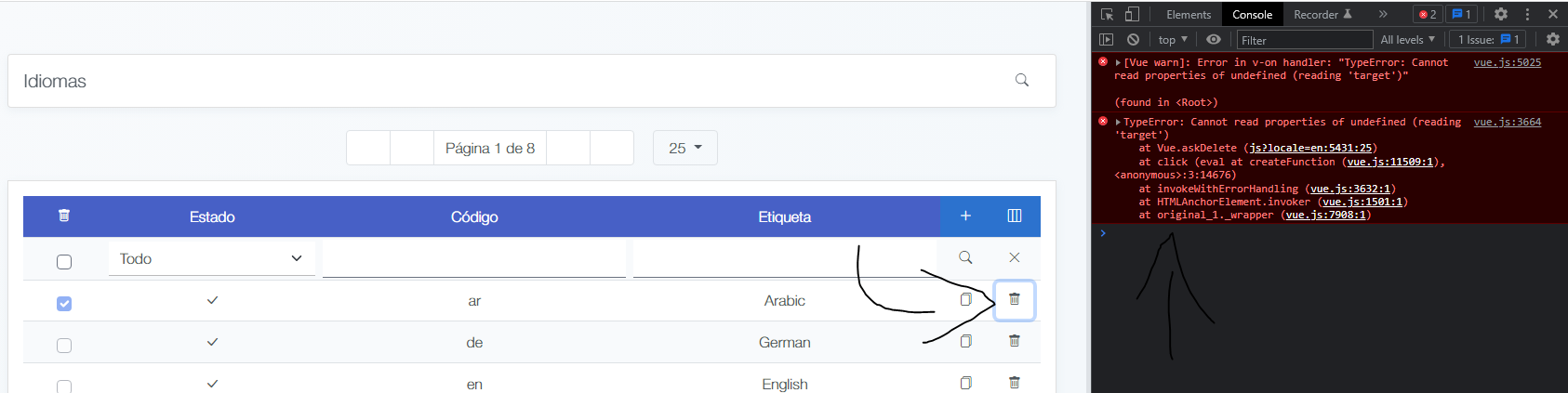

Sure, I share a screenshot with you. When I click on the icon to delete, it does not work and shows that error in the console.
Regards,
Regards,
- delete errror.PNG (65.39 KiB) Viewed 8166 times

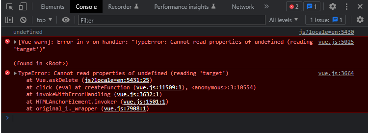

Added the console.log(ev) to vendor/aimeos/ai-admin-jqadm/js/admin.js
Attached screenshot.

Thank you very much for your prompt response,
The line of code is different in packages/my-theme/templates/admin/jqadm/locale/language/list.php
It is as follows:
<a class="btn act-delete fa" tabindex="1" href="#"
v-on:click.prevent.stop="askDelete(`<?= $enc->js( $id ) ?>`)"
title="<?= $enc->attr( $this->translate( 'admin', 'Delete this entry' ) ) ?>"
aria-label="<?= $enc->attr( $this->translate( 'admin', 'Delete' ) ) ?>">
</a>Attached screenshot.
Best regards,
- console-admin-js.PNG (20.65 KiB) Viewed 8100 times
