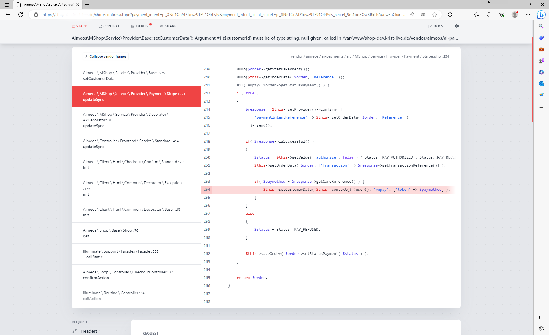

The line may be a problem because the UNFINISHED state is -1, not empty.
What's the error that you receive if the block is executed?
nowrap
Posts: 37
Joined: 01 Mar 2023, 23:03
Re: stripe & mastercard SecureID
Post by nowrap » 14 Aug 2023, 11:46
$this->context()->user() is null and throws an exception that the customerId for setCustomerData() is not a string
(the screenshot shows it: download/file.php?id=1571)
