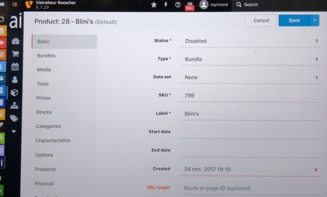

Re: Can't save products on iPad
Post by webshade » 03 Dec 2019, 12:30
It's in the admin interface. See attachment.

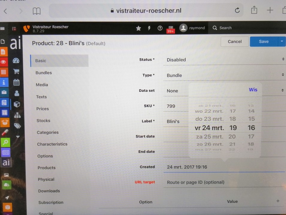

Post by webshade » 03 Dec 2019, 13:37
Attached the datetime selector. It's already filled with a date, but it seems like that Ipad the date conforms to another format.
Screen 2 iPad.jpg (145.35 KiB) Viewed 7763 times

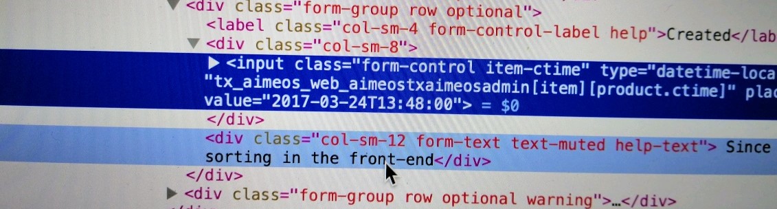

What value gets inserted into the intput field? You need to check using the browser console of a Safari browser.
webshade
Posts: 30
Joined: 19 Apr 2017, 13:51

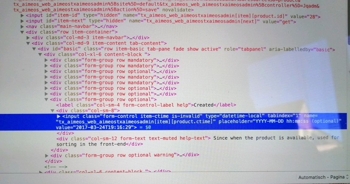

Post by webshade » 04 Dec 2019, 09:40
As you can see it adds a "T" between date and time. When I manually remove the "T" in the HTML it saves correctly.

Posts: 8625
Post by aimeos » 04 Dec 2019, 09:54
The "T" is correct and I think it works if you remove it because the rest of the value is ignored then.
The underlying problem might be the value for the seconds. Can you remove ":29" and see if that works too?
Post by webshade » 04 Dec 2019, 10:29
When I remove the seconds, it can save either. But the format remains the same. See screenshot.
After I saved it once I can save that item next time again without any problems. Seems like there's first some manual adjustment needed to trigger an iPad to save the products... Weird.
Posts: 8625
Post by aimeos » 04 Dec 2019, 10:59
We've changed the datetime values and remove the seconds. If you have a composer based installation, you can use that command to update to the latest 2019.10 commits:
composer req aimeos/ai-admin-jqadm:2019.10.x-dev
The next TER package will be released in approx. two weeks.
