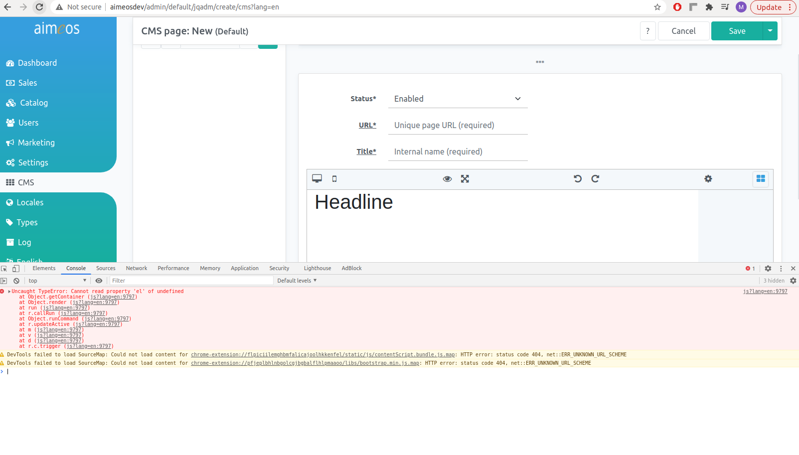

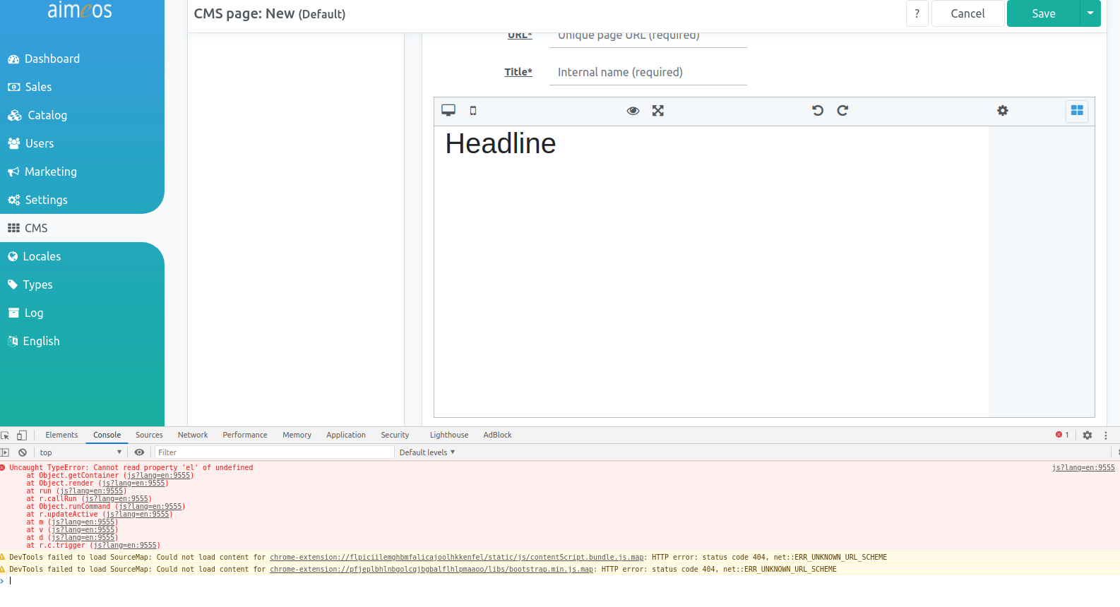

Re: CMS extension
Hi there, just tried to get updated extension.
I have installed the project with the following commands:
And I noticed some problems:
When I am on cms main page - there is error 'Unable to call method "storeSearchParams"'.
I have added new page, but page is not displayed on main cms page and no on tree..
Also js error in console..
Here my versions I tried with:
composer create-project aimeos/aimeos:dev-master aimeosdev
composer req aimeos/ai-cms-grapejs:dev-mainWhen I am on cms main page - there is error 'Unable to call method "storeSearchParams"'.
aimeos/ai-admin-jqadm dev-master 636ffbb Aimeos Vue.js+Bootstrap admin interface
aimeos/ai-admin-jsonadm dev-master 4066c11 Aimeos ai-admin-jsonadm extension
aimeos/ai-client-html dev-master b9f1e5d Aimeos ai-client-html extension
aimeos/ai-client-jsonapi dev-master 45ba16b Aimeos JSON API extension
aimeos/ai-cms-grapejs dev-main 3bf47c8 Aimeos GrapesJS CMS extension
aimeos/ai-controller-frontend dev-master d659352 Aimeos ai-controller-frontend extension
aimeos/ai-controller-jobs dev-master dd4c56b Aimeos ai-controller-jobs extension
aimeos/ai-gettext dev-master 2c12fb9 Aimeos Gettext extension
aimeos/ai-laravel dev-master 82ed2ab Laravel adapter for Aimeos web shops and e-commerce solutions
aimeos/ai-swiftmailer dev-master ceb8275 SwiftMailer adapter for Aimeos web shops and e-commerce solutions
aimeos/aimeos-core dev-master 6ae50ca Full-featured e-commerce components for high performance online shops
aimeos/aimeos-laravel dev-master b771b5e Professional, full-featured and high performance Laravel e-commerce package for online shops and complex B2B projects
