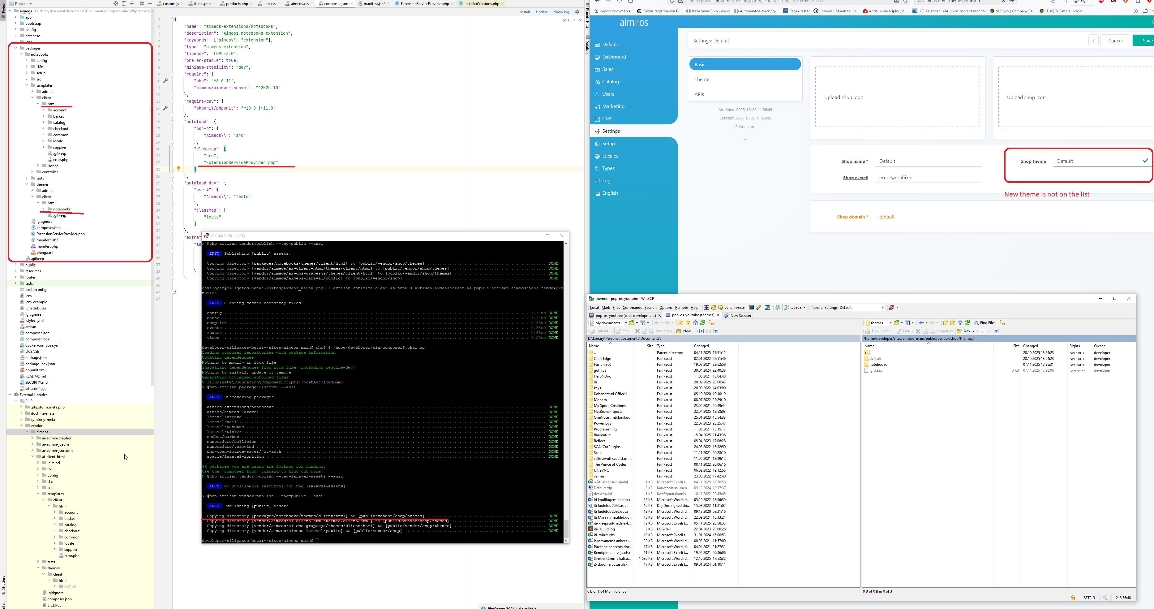

I created a new theme under the ./packages directory.
Partials are recognized just fine and composer updates fine, but CSS and JS files are loaded from default. Also under the admin settings the new theme is not on the list.
Here is a picture that shows, that files themselves are copied correctly.
How does the theme detection work? I could rename the theme to "defaul" but, I think it would not be a proper step.

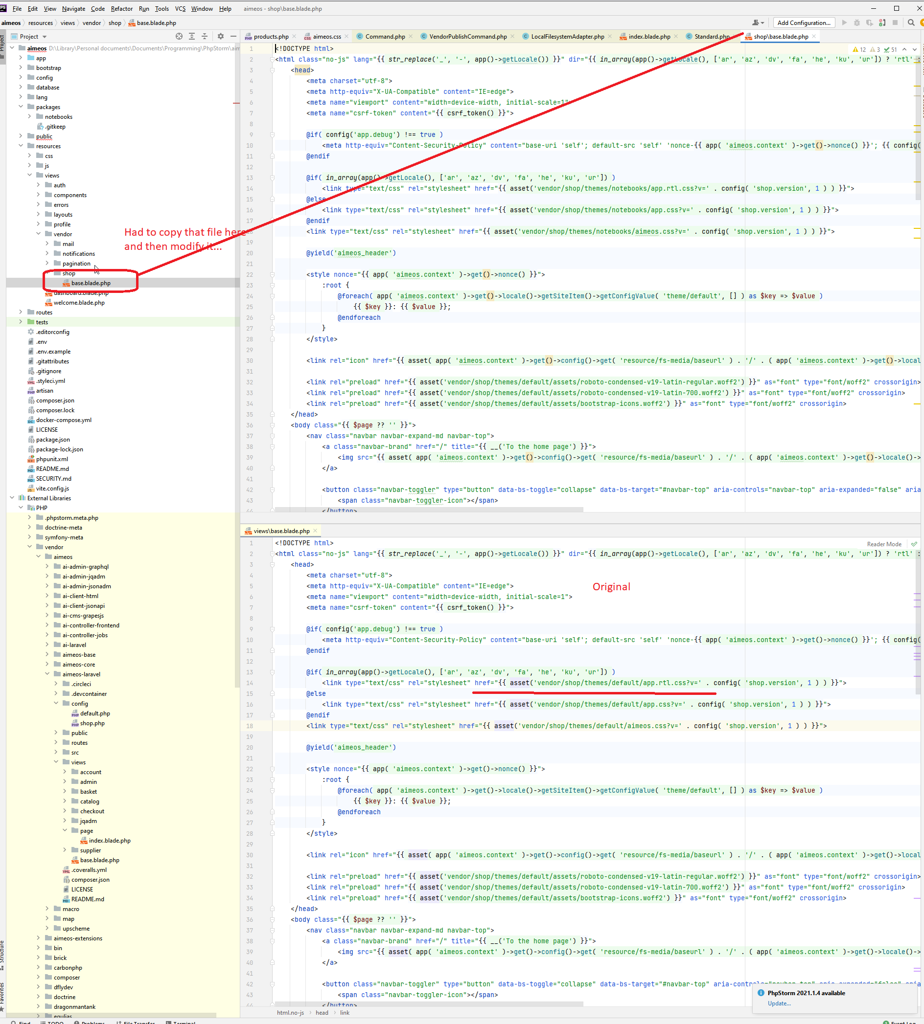

Usually I do not write here if it is a cache issue. To me it looks more like some assets are hardcoded.
When I copied "base.blade.php" to "~/resources/views/vendor/shop" directory and changed the contents. then it worked.
But my assumption was that it would also work when it is in a separate package such as "~/packages/notebooks/views/base.blade.php"

Picture attached.
Posts: 8738
Re: Created a new theme, but it is not recognized
Post by aimeos » 10 Nov 2025, 10:53
Your "notebook" package contains a "views/base.blade.php", which should be used if you select the theme in the Aimeos backend settings. The view itself references CSS/JS files which are included in your package but they are stored in the themes/default folder and that's the reason why you see the "default" CSS/JS links in the HTML output. The solution is to adapt the "views/base.blade.php" in your "notebook" extension to use the files from the vendor/theme/default you've probably renamed to vendor/theme/notebook.

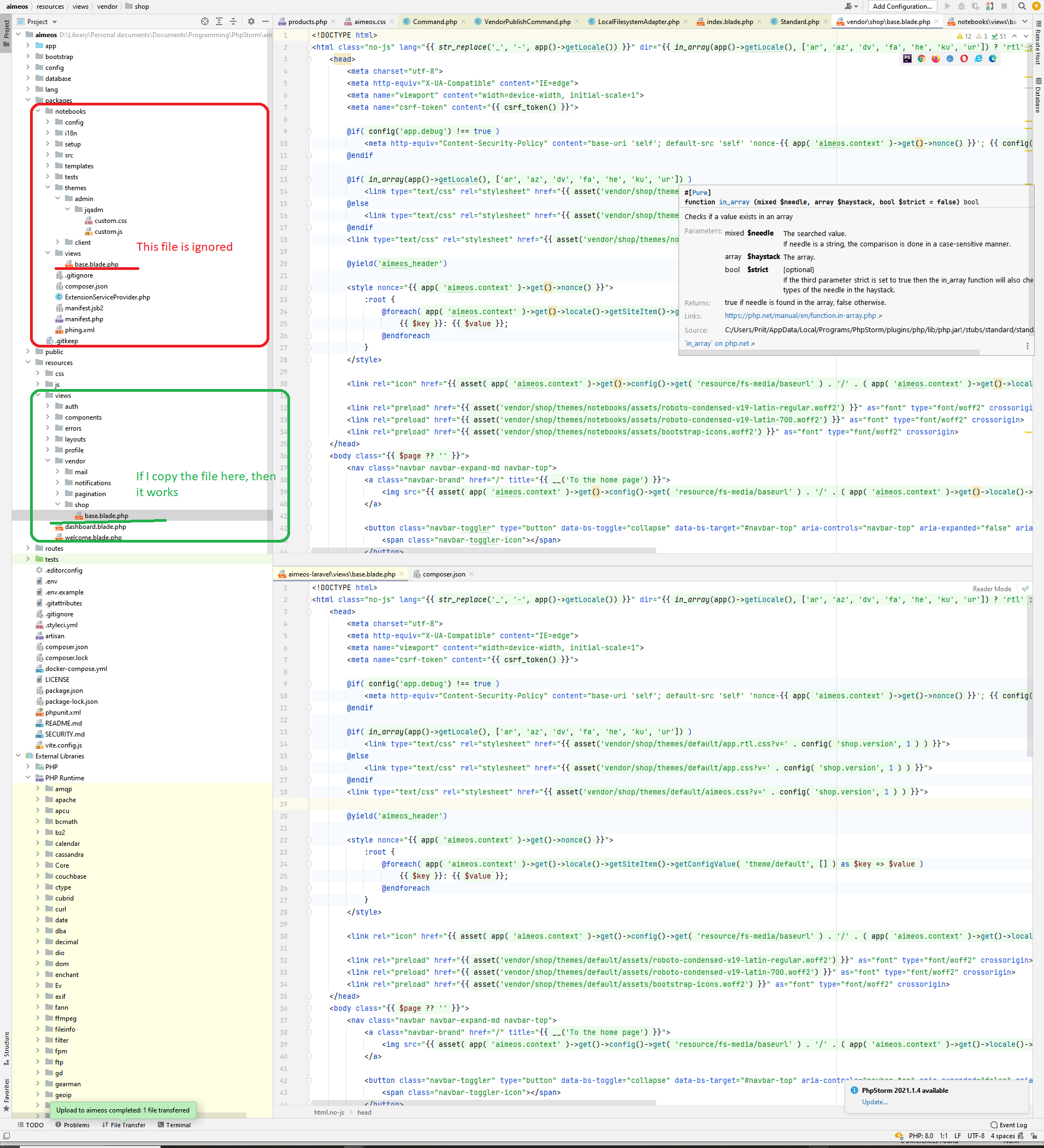

I do not want to create a new extension every time. I would like to know how things work under the hood. Anyway I checked for the diff and found out that this was the only changed file.
Of course a huge load of files were also present under the ~/notebooks/views that are not included on my plugin (except for the base.blade.php). I am assuming that only those files need to be included, which are different from the default. If that is not the case, then I would say, it is not a very good design.
But end result is that it is not working.
If I copy ~/packages/notebooks/views/base.blade.php to /resources/views/vendor/shop/base.blade.php then it works immediately. Even without refreshing cache.
Each test was performed in incognito browser, so cookies and sessions should not be an issue.
Picture of the folder layouts:
