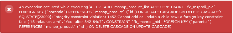

When I try to install I get this exception.
PHP 8.2.24
Typo3 v12.4.23 LTS
Aimeos web shop 24.10.2
Re: ai-customergroups - Price missing
Post by aimeos » 09 Dec 2022, 08:00
You ran the TYPO3 database analyzer, allowed it to remove the Aimeos foreign key constraints and have dangling references in your mshop_product_list table now which you have to remove first.

Post by Moritz » 09 Dec 2022, 08:32
Yes, I have deleted the foreign keys with the analyzer.
I restored the DB and now the installation works.
But the problem consists.
It is the same problem that I describe in the first post.
When I add a new price item the cgroups column is null and not 0.
