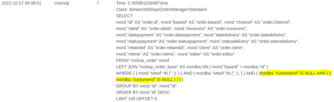

Then, check the logged SQL statements in the Aimeos Log panel and search for the one that retrieves the orders for the order history. Test that SQL statement e.g. in phpMyAdmin and remove conditions until you found out why it didn't return anything.
Here are only select orders without a customer ID?

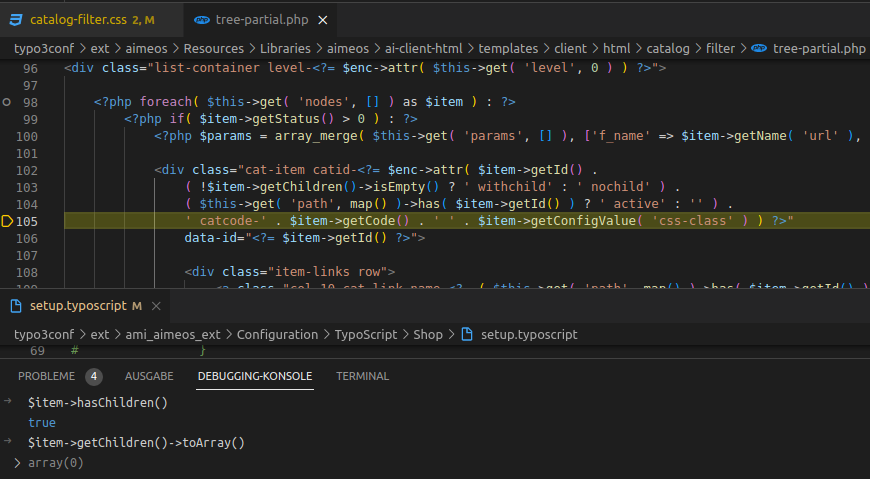

I debugged the tree-partial.php and found out that you used $item->hasChildren() in v22.7.4 to check if the node has child categories.
Now you use $item->getChildren()->isEmpty().
But they have different results?

Moritz wrote: 17 Oct 2022, 09:28 I debugged the tree-partial.php and found out that you used $item->hasChildren() in v22.7.4 to check if the node has child categories.
Yes, there's a difference: "$item->hasChildren()" returns true if there are children in the database but not fetched while "$item->getChildren()->isEmpty()" returns only true if there are actually child nodes loaded from the database.
If you want a megamenu or always show e.g. the first category level in your category tree, you must set the level-always setting in the flexform of the plugin to the number of category levels you want to display.

Moritz wrote: 17 Oct 2022, 08:17 Here are only select orders without a customer ID?
There was a line missing that prevented the user ID from being used:
https://github.com/aimeos/aimeos-typo3/ ... xt.php#L13
Can you add that line and check if it works now?

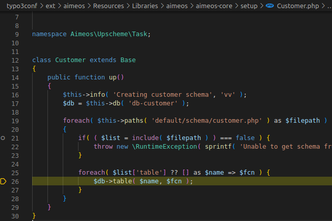

Can you please check if the TablesMigrateSiteidTypo3.php task runs before the Customer.php task and if the customer task generates an ALTER TABLE statement?
Do you mean the "typo3conf/ext/aimeos/Resources/Libraries/aimeos/aimeos-core/setup/Customer.php"?
If yes, the "TablesMigrateSiteidTypo3.php" runs before it.
But i don't know how to get the SQL here:
PHP 8.2.24
Typo3 v12.4.23 LTS
Aimeos web shop 24.10.2
Post by aimeos » 17 Oct 2022, 11:53
If there's any ALTER TABLE statement, it will be printed after the output of "Creating customer schema".
Can you check if the fe_users.siteid and fe_users_address.siteid columns contains any records with siteid of NULL after the migration from 18.10 to 22.10?
