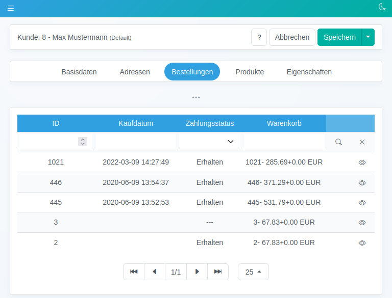

Sorry it was my fault.
I didn't upgrade from my 18.10 database structure.
Now the users are in the list.

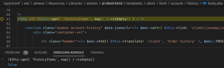

But I saw no order in frontend for my user.
In the template file of the order history no orders are found for this user.
PHP 8.2.24

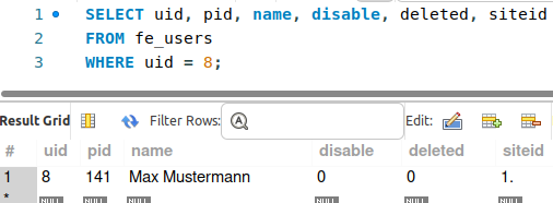

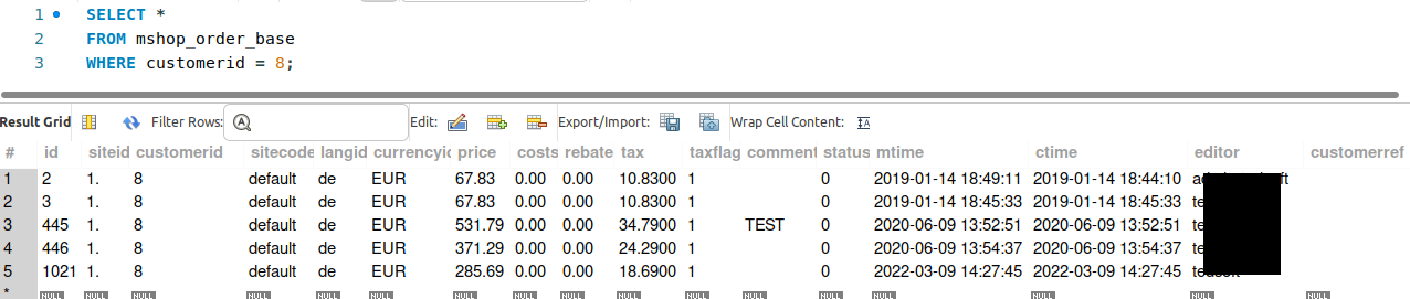

Did you check if fe_users.uid is the same as mshop_order_base.customerid?
Moritz
Posts: 158
Joined: 07 Nov 2018, 14:05
Post by Moritz » 13 Oct 2022, 10:19
Yes.

Is the site ID different?
Moritz
Posts: 158
Post by Moritz » 13 Oct 2022, 10:32
The site ID of users and orders are the same.
Or do you mean another one?

Can you please enable debug logging of the executed SQL statements to check why that happens?
Moritz
Posts: 158
Post by Moritz » 13 Oct 2022, 14:42
The problem is that I do not know the reason why the orders are not displayed.
Due to this ignorance, I also don't know where to investigate.
I can provide you with the results of the upgrade wizard. Debug logging should be enabled there.
DB was v18.10.11 and Aimeos v22.10.1-pre2.
SQLs_upgrade_wizard.zip
(12.41 KiB) Downloaded 1401 times
