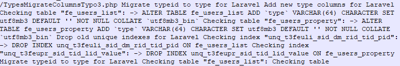

Post by Moritz » 18 Oct 2022, 08:14
This is the log output of the migration.

Post by aimeos » 18 Oct 2022, 08:26
Seems to be correct, the type columns are created and data is migrated.
The typeid columns are not removed automatically to avoid data loss.

Post by Moritz » 18 Oct 2022, 08:56
Ah ok, I misunderstood that.
The download function works now.
Thank you for the great support up to this point!
