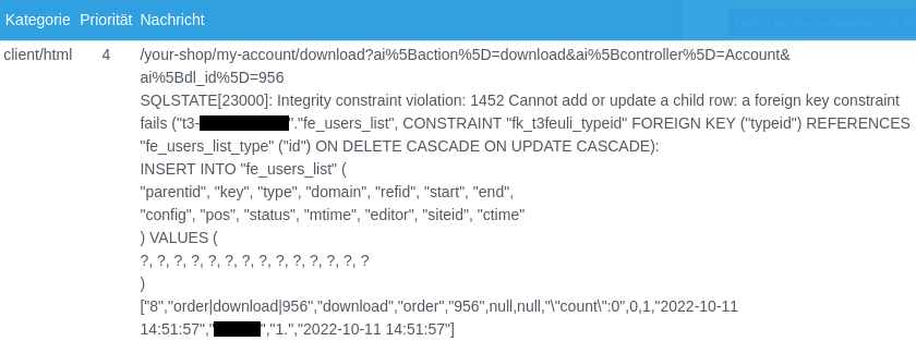

I found another issue when I want to download a file from order.
There is a foreign key on fe_users_list.type to fe_users_list_type.id of datatype integer.
The SQL tries to insert a string in this column.
The exception occurs in "aimeos/Resources/Libraries/aimeos/ai-client-html/src/Client/Html/Account/Download/Standard.php(243)".
Maybe there is a missing migration of the foreign key?
PHP 8.2.24
Typo3 v12.4.23 LTS
Aimeos web shop 24.10.2
Posts: 8746
Post by aimeos » 12 Oct 2022, 11:21
The setup task for migrating the type columns in the fe_users_* tables had been removed by accident in 2022.04. Now, it's available again in the 22.10.1-pre1 pre-release. Please test if the typeid column in fe_users_list and fe_users_property is changed from INT to VARCHAR:
https://aimeos.org/fileadmin/download/a ... 1-pre1.zip
