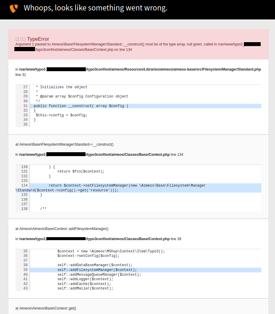

Post by Moritz » 11 Nov 2022, 11:54
When I go to Admin Tools -> Upgrade -> Check TCA I get the following exception.
PHP 8.2.24
Typo3 v12.4.23 LTS
Aimeos web shop 24.10.2

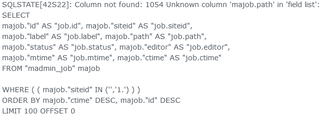

Post by Moritz » 11 Nov 2022, 12:18
I upgrade on the clients test machine and get another error in the upgrade wizard.
PHP 8.2.24
Typo3 v12.4.23 LTS
