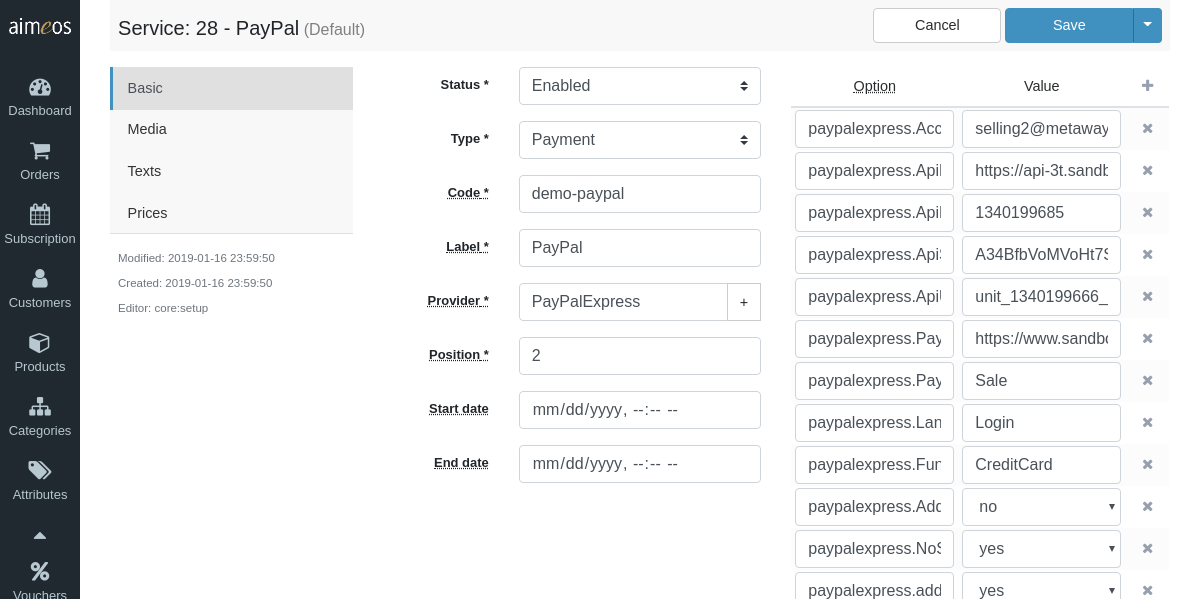

I am new to aimeos shop. I have created the invoice payment using this "https://aimeos.org/docs/Developers/Libr ... t_provider" docs but payment not shown in the frontend.
after Manual adding payment in service tab only payment shown in frontend.if there is any direct composer update to shown payment in frontend (or) to update service. And I need other help how the payment folder structure should be?

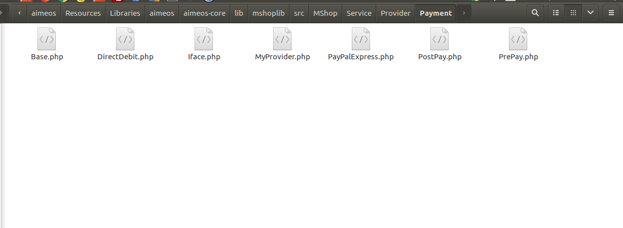

I have Changed anything from the docs given just create the Myprovider.php file with Process function in the Shop root "aimeos/aimeos-core/lib/mshoplib/src/MShop/Service/Provider/Payment"
Docs is not clear for me, I think just create the PHP file in the service folder is enough to show the payment in the frontend.
Now I think its totally wrong, but how the payment has to create as like plugin- just upload the folder to showing the payments.

Post by aimeos » 27 Aug 2019, 07:11
You have to create your own TYPO3 extension using the Aimeos extension generator, install that TYPO3 extension and place your file in the ./typo3conf/ext/<extname>/Resources/Private/Extensions/<extname>/lib/custom/src/MShop/Service/Provider/Payment/ directory:
- https://aimeos.org/docs/Developers/Create_an_extension
- https://aimeos.org/extensions
