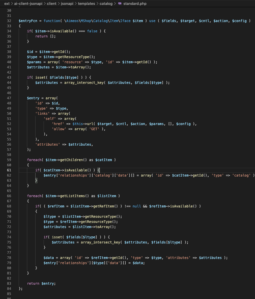

I am checking the source code of Json API and found the reason here:
ext/ai-client-jsonapi/client/jsonapi/templates/catalog/standard.php
Screen Shot 2021-01-06 at 1.54.13 PM.png (180.91 KiB) Viewed 8416 times
- The catalog relationships are manage by the catalog table rather than catalog.list so the line 66 wont execute
- The line 59:
if you call the API with the First way (follow the docs) it is execute.
if you use the second way, (search catalog with level: 0 , include:text, catalog) this will not execute.
Please help me check it, and give me the way to get the Include Child catalogs from the search without using catalog.lists manage relationship

If you restrict the categories to level "0" in your filter, only the root node will be returned. Instead, use this to get the root node and all categories one level below:

There may be cases where this a valid requirement provided you have a low number categories (like in your case). We've added a new configuration in the dev-master branch to allow fetching the complete catalog tree now:
https://github.com/aimeos/ai-client-jso ... 0b0dbafc6b

Remember, it's only in dev-master branch of the aimeos/ai-client-jsonapi package. You are likely using a ~2020.10 version.
Yes, the whole tree will be returned if you enable this option and use "include=catalog" in your request.
