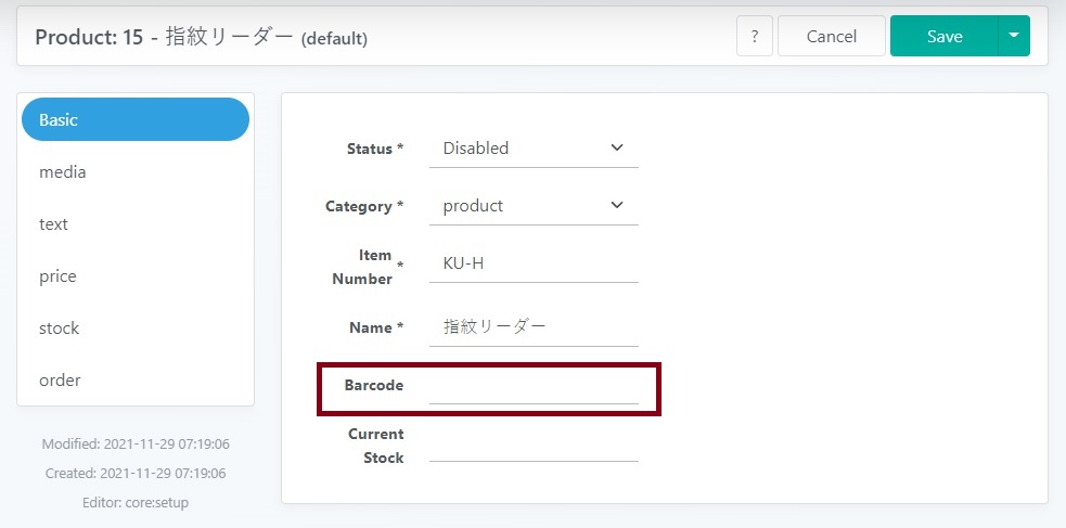

Can you please help in my code to work with product decorator which will display the 'barcode' column from product table which was added after I extend in ext\ai-laravel\lib\custom\setup\default\schema\product.php. I was working fine in the database after I run php artisan aimeos:setup.
I would like to display the value of the product.barcode column in the product edit page based on

I tried to display the value of barcode in \ext\ai-admin-jqadm\admin\jqadm\src\Admin\JQAdm\Product\Standard.php
but it just display the default value because it returns null value.

Or in
\ext\ai-admin-jqadm\admin\jqadm\templates\product\item-standard.php would still return a null value.
$enc->attr( $this->get( 'barcode' ) )
