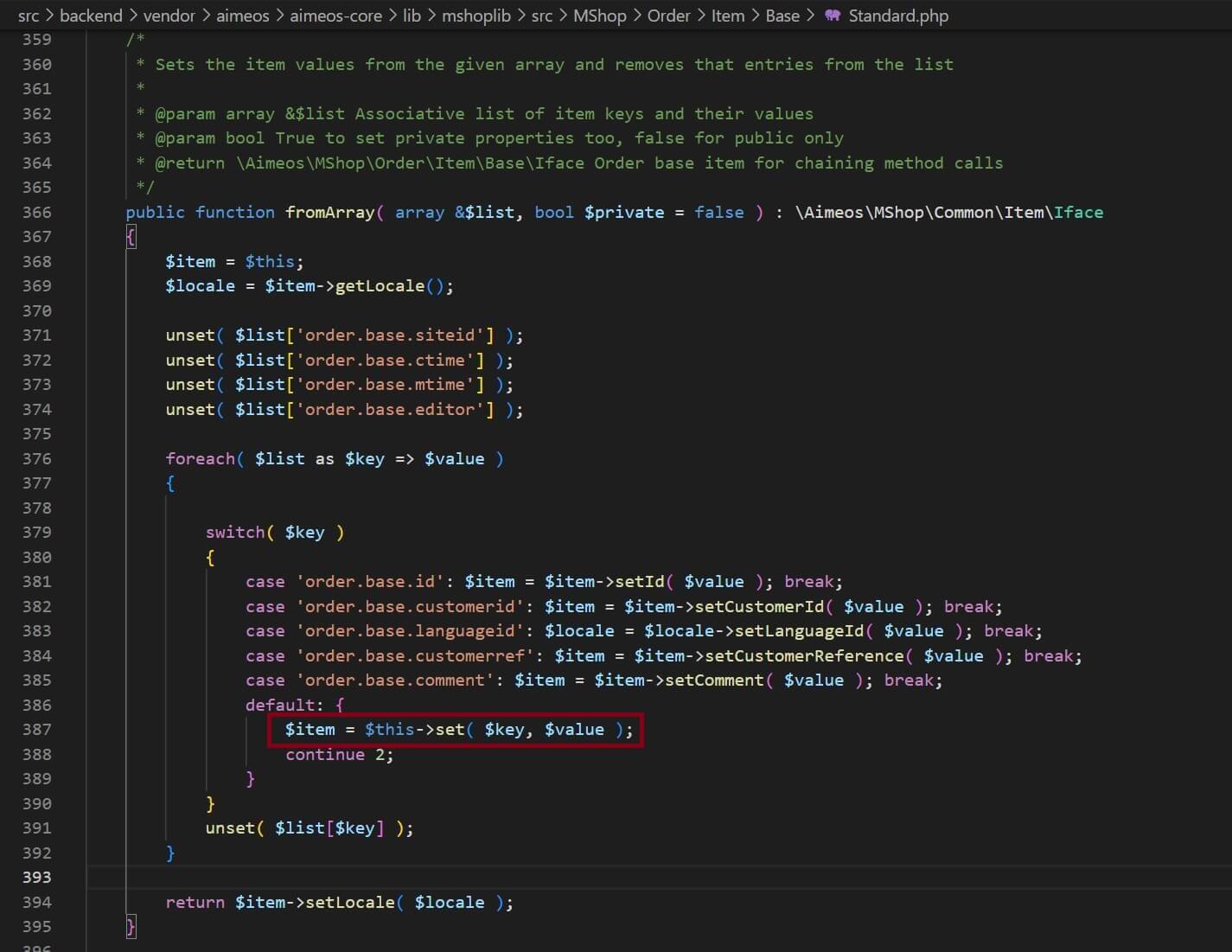

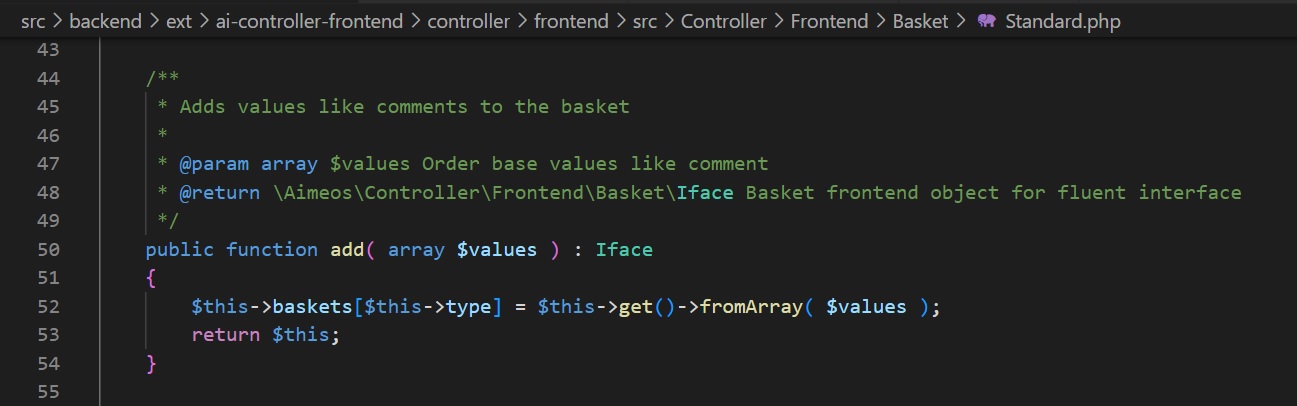

Thank you for that information.. I was able to trace the flow or data up to the last part in the core. I noticed that my added array has no chance to be stored and part of the added fields to be inserted just as what happen in order saving process.
I traced in this part fromArray() of order base part. The add() function has no way to be stored in the object to save "order_base" returning itself without saving the added array compared to "order" add() function which returns the added array and saved the added new field.
I have found a work around the only way I can save the added array in line 387 to store it in the object but this is in the aimeos core code part which is not the best solution. Kindly provide us the best solution without touching the aimeos core code.

Thanks for tracking this down!
This is a left-over from the past where order base item doesn't extend from the common item class and where the code was duplicated in the order base item - but not for the custom properties. This has been fixed now in 2021.10.x-dev. Can you please test?
In dev-master, the order base item extends from common item class so this won't be a problem any more :-)

I switch now from aimeos/aimeos-core from 2021.10.19 to 2021.10.x-dev and it work. My added new fields are successfully saved to order_base table. Thank you so much.
