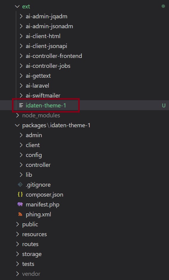

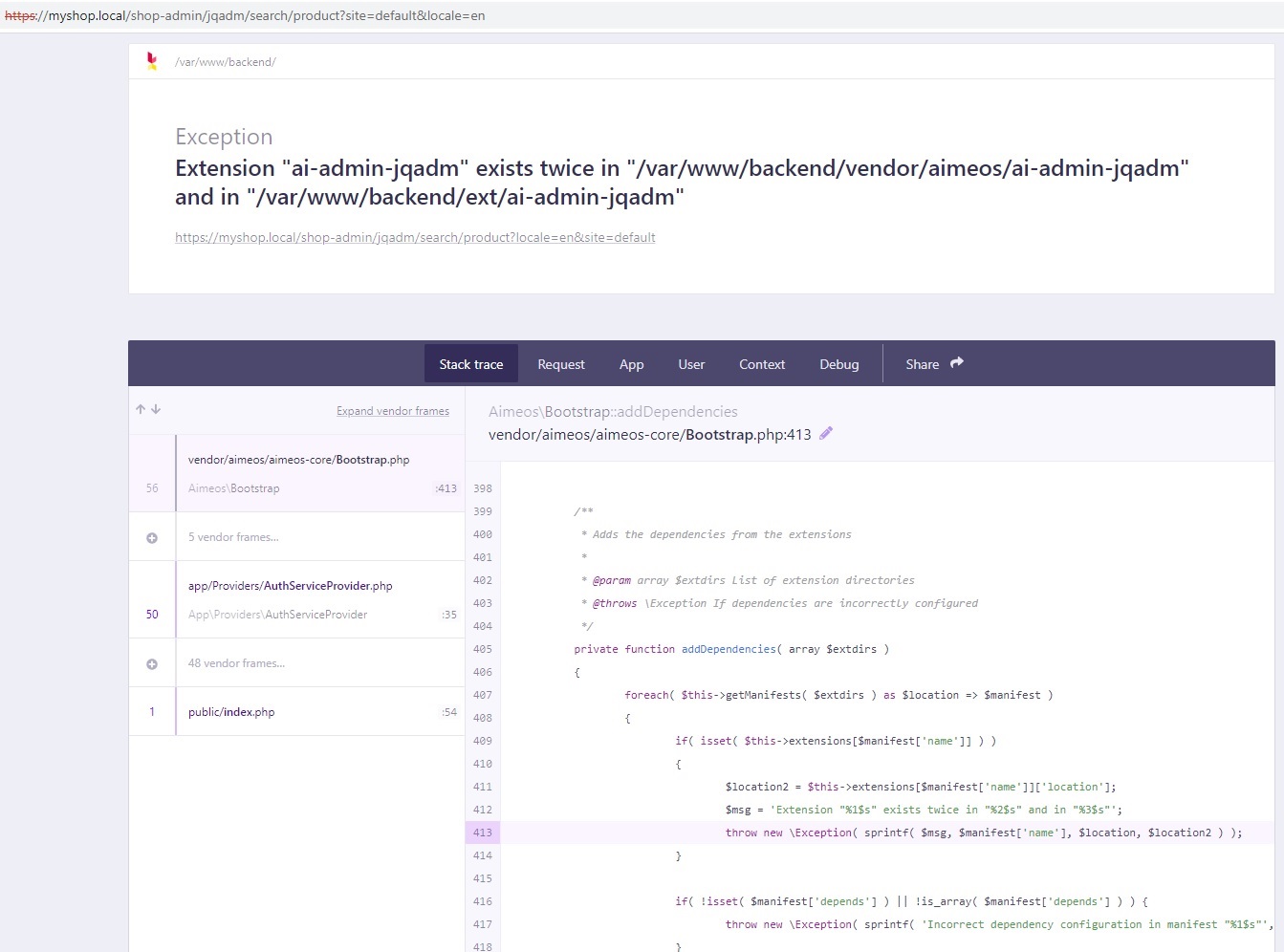

I am using laravel 6.x, PHP 7.4, Docker desktop/Ubuntu and the Aimeos 2021
I would like to ask how to configure the aimeos not to cause issue like this if I already have a modified aimeos codes in /ext?
Everything in composer install aimeos to php artisan vendor:publish --all works fine. But after running php artisan aimeos:setup encounter the same issue the same like checking the page.
But if I removed the /ext folder our aimeos modified codes the php artisan aimeos:setup works fine.
Please help how to configure aimeos to recognized the /ext folder in the project.

When you upgrade from a version before 2021.07, you need to remove the ./ext/ai-* folders because they are now installed in ./vendor/aimeos/. Your own extension can still be in ./ext/

I am not upgrading. I just want to know what to do or configuration to recognized the modification we made in /ext once we install a theme because it is overwriting the existing /ext. Please help what should I need to know or configure to avoid it.

The best solution is to merge your code from your extension located in ./ext/ into the theme extension you've created. Both have the same structure and this prevents you from having to look at two different places.

Yes that's what I did but why am I seeing that error after installing the extension?

No extensions with ai- prefix must be in the ./ext/ folder after 2021.07.
Please remove them using:
rm -rf ext/ai-*

If I do the remove the prefix ai- inside ext folder then this will happen?
But if I removed this created file after composer update then I won't get any issues of Extension exists twice?
Does it need to be like this that we need to remove that file or I did something wrong?

Execute this after you've removed the "ai-*" extensions from the ./ext/ folder:
composer up
Furthermore, install your theme using composer too like described here:
https://aimeos.org/docs/latest/laravel/ ... stallation
