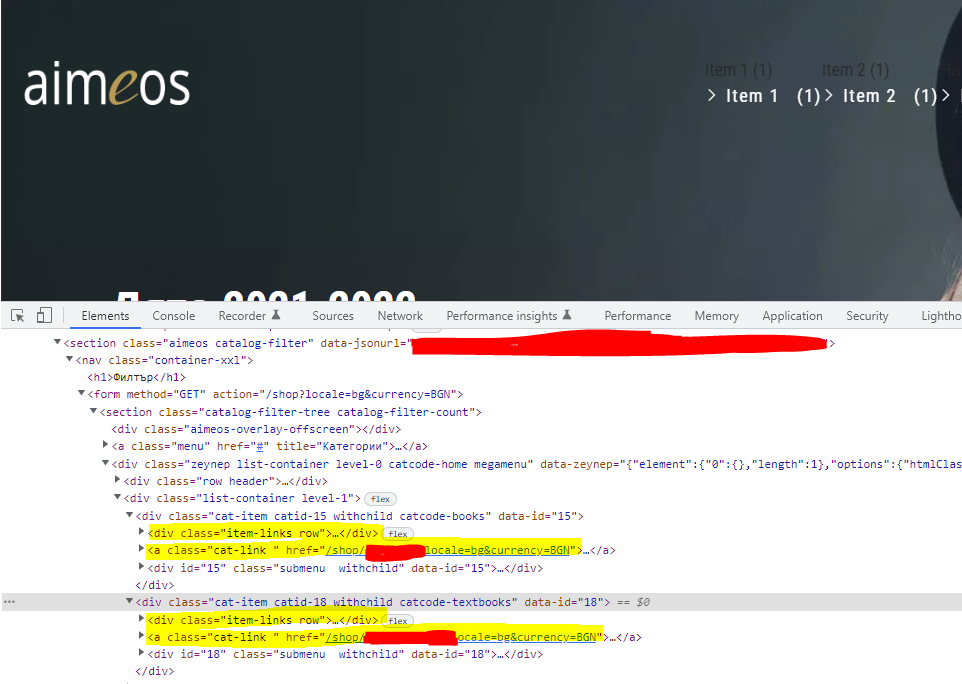

I have created a theme extension, but the issue persists when I switch to the new theme.
Steps to reproduce:
1) Create a mytheme Laravel theme 2022.x extension here:
https://aimeos.org/extensions
2) Upload the theme to packages/mytheme
3) Execute composer update
4) Switch to the new theme from the settings
If not switched to the new theme, there are no errors.
I attached an image showing what it looks like

Re: Theme navigation duplicated after "composer upgrade"
Post by aimeos » 24 Oct 2022, 16:18
Tested locally but unable to reproduce.
According to your screenshot (browser inspector), there's also no HTML node twice.
There's only something in the background which looks like a shadow of the navigation.
