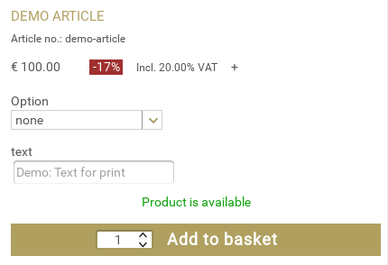

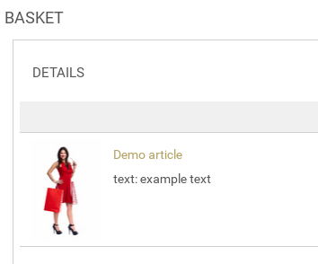

Re: Reservation System
We've implemented custom attributes with arbitrary values in the latest core. That should be what you need get your reservation system up and running. The current demo data deals with texts but you can store dates as text as well.alpin3rocker wrote: Now the problem is, that i dont know if it is possible at that way or how i can pass the Value of the Startdate-input-field in to the Database and through the next order Steps.
- basket-detail.png (13.63 KiB) Viewed 43381 times
- demo-product.png (13.71 KiB) Viewed 43381 times
- admin-interface.png (21.33 KiB) Viewed 43381 times

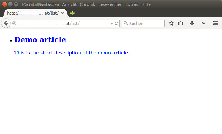

I tried to update/replace only the arcavias-core in the installed Aimeos extension Typo3 7.1.0.
After that i pressed the green update circle-button of Aimeos in Ext-Manager.
But the Frontend looks like in the Attachment. What is wrong? Or How should i do the update the right way?

from the Log, maybe it is helpful for you...
Core: Error handler (FE): PHP Catchable Fatal Error: Argument 2 passed to MW_View_Helper_Partial_Default::__construct() must implement interface MW_Config_Interface, none given, called in /user/www.domain.at/typo71/typo3conf/ext/aime ... efault.php on line 57 and defined in /user/www.domain.at/typo71/typo3conf/ext/aime ... efault.php line 32
You need the current TYPO3 code and the latest core because both need to play together.alpin3rocker wrote: I tried to update/replace only the arcavias-core in the installed Aimeos extension Typo3 7.1.0.
