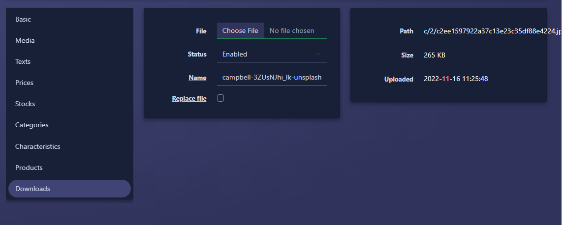

I got this error, when updating the product details:
The problem is from the download file, as you see in the picture, the file has been uploaded and it's details is displayed correctly. Now when I click on the save button, the file details disappeared, and the "$this->get( 'downloadData/attribute.code' )" return empty "".
SQLSTATE[23000]: Integrity constraint violation: 1062 Duplicate entry 'product-1.-download-' for key 'unq_msatt_dom_sid_type_code':

#66 main- Attachments
- Screenshot 2022-11-16 133345.png (80.91 KiB) Viewed 4723 times
Re: issue when updating a product
Which Aimeos version are you using?
In the current 2022.10 version it works without problems.
It seems like the file path isn't set in the attribute item as code somewhere here:
- https://github.com/aimeos/ai-admin-jqad ... #L308-L317
- https://github.com/aimeos/ai-admin-jqad ... #L266-L284
Can you check what exactly happens there?
Aimeos v2022.10
The problem is solved. By mistake, I was comment the hidden-attribute component.
