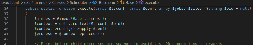

I found it.
In the execute function you call self::context($tsconf, $pid) before $context->config()->apply($conf).
But in self::context($tsconf, $pid) the view is already created with the old config of the context.
Maybe it's enough to swap the two lines or does that affect the rest of the code?

Re: Payment email exception for payed orders
Post by aimeos » 25 Nov 2022, 13:50
You can't swap the two lines but maybe it's enough to swap $conf and $tsconf variables.

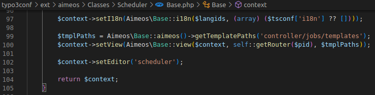

Post by Moritz » 25 Nov 2022, 13:57
You're right, I've written faster than thinking 😅
I don't know if that works.
Inside the context function you use i18n from $tsconf.
Post by aimeos » 25 Nov 2022, 14:23
Maybe using apply for both config arrays works better:
$context->config()->apply($conf)->apply($tsconfig);
Moritz
Posts: 158
Joined: 07 Nov 2018, 14:05
Post by Moritz » 28 Nov 2022, 09:00
You mean here after creating the $context https://github.com/aimeos/aimeos-typo3/ ... se.php#L79 ?
Because the context() function requires the config as parameter.
Post by aimeos » 28 Nov 2022, 11:16
Yes, because you can pass the $tsconf variable to the context() method nevertheless.
