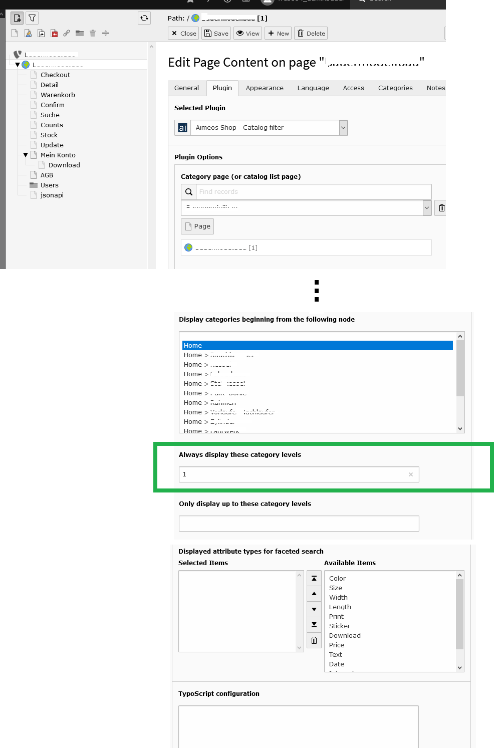

In TYPO3, the TS settings are overwritten by the Flexform settings, so you have to go to the plugin configuration of the catalog filter plugin and add the value (2 or 3, depending on the levels of your tree) to the "levels always" field in the flexform.

whatever i enter in the "Always display these category levels" field, 0, 1, 2 or 3, nothing happens... i tryed clear cache / delete typo temp folder but Categorys still closed. Or i misunderstood how to configure it?
Catalog filter.png (61.9 KiB) Viewed 19367 times

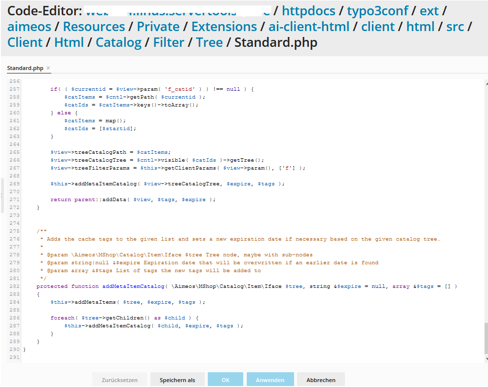

1.) this file was OK:
httpdocs / typo3conf / ext / aimeos / Resources / Private / Extensions / ai-controller-frontend / controller / frontend / src / Controller / Frontend / Catalog / Standard.php
2.) This part didnt changed after update:
i adjusted it to your change:
$view->treeCatalogPath = $catItems;
$view->treeCatalogTree = $cntl->visible( $catItems->keys()->toArray() ?: [$startid] )->getTree();
$view->treeFilterParams = $this->getClientParams( $view->param(), ['f'] );
... cleared cache / temp folder... still nothing, i have the feeling that the configuration "Always display these category levels " is dead somehow.
