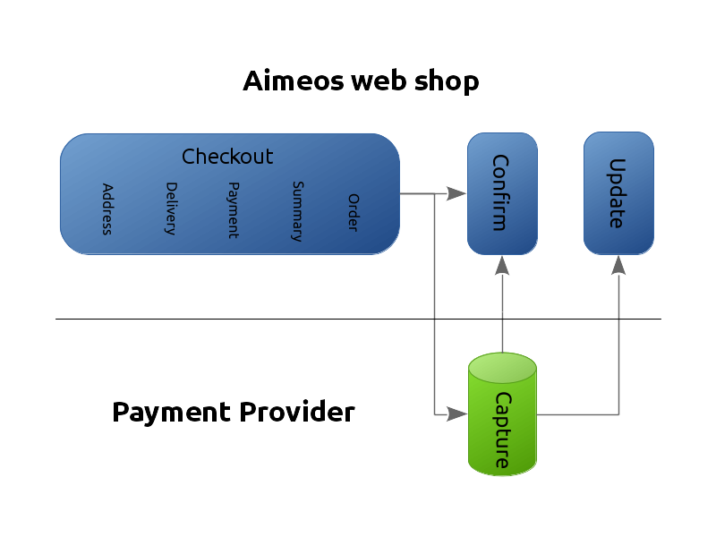

Checkout steps#
All steps are implemented as subparts of the "checkout standard" component. The difference between this component and others is that only the subpart is shown that matches the step in the URL parameter or the first one that requires attention if the page is called without parameter.
Moving through the steps is done by instantiating all subparts, calling their init() methods and the one that requires some input will set the standardStepActive view variable to its own subpart name. This subpart is rendered afterwards and the init() method of the address subpart is a good place to see how this works.
If a customer is already logged in and the Autofill basket plug-in is configured, then the address data as well as the chosen delivery and payment options are used from the last order. The steps that doesn't require any input are skipped and the configured destination page (the summary page by default) is displayed directly to the customer.
Payment processing#
Afterwards, the order is stored in the database and the product stock and coupon code(s) are blocked (their count is decreased). If the payment fails or the customer leaves the shop before completing the order, the order stays in the database and products and coupon codes won't be available for other customers.
Tip
There's a job controller ("Remove unpaid orders") available for unblock reserved stock and coupon codes of unpaid orders after a configurable amount of time. Also, unfinished orders can be deleted safely after some time using the "Remove unfinished orders" job controller.
A new delivery address is also saved in the customer address table. To prevent this, you have to remove the "address" subpart from the process subparts configuration. This applies also to creating a new customer account based on the e-mail address.

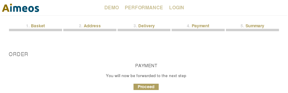

If the customer has chosen a payment provider which requires no redirect to an external payment gateway (like pre-payments), the customer is directly forwarded to the order confirmation page which must contain the "checkout confirm" component.
Otherwise, a form is shown which asks for the required data like credit card information. Submitting the form (done automatically if no further data is required and Javascript is available) will forward the customer to the payment gateway where acquiring the payment takes place.
The payment gateway must redirect the customer back to the confirmation page afterwards to complete the order. Additionally, it's possible to accept order status updates via the "checkout update" component sent by the payment gateway later on.
Confirmation page#
The "checkout confirm" component displays the placed order and the current payment status of that order.
If possible, it updates the payment status depending on the parameters sent by the payment gateways or queries the payment provider for the current status. It asks each configured payment provider for the current shop site to update the payment status until one of them succeeds.
Thus, and for usability reasons it's best to place the most commonly used payment option at the top of the list of payment options using a low number (or zero) for the position value.
Sometimes, payments of customers are declined by the payment provider or the payment fails for other reasons. In this case, the buttons for retrying the payment are displayed. The customer can use the same payment option or choosing another one.
Update notifications#
The payment status of an order can change due to external reasons like the payment was pending first and succeeds afterwards or it was declined by the credit card provider. It's important for a shop to get notified about these changes. For example, Aimeos shops hold back orders as long as their payment is neither "authorized" nor "received".
The notifications about payment status updates can happen every time and are therefore not bound to any direct customer action. Instead, the payment provider gateways may send them as soon as they occur or maybe only once a day. Thus, they are distinguished into two types:
- real-time/synchronous update
- batch/asynchronous updates
All real-time updates are sent directly to the "checkout update" component of your Aimeos shop. Some payment service provider implementations are able to hand over the URL created by using the configured destination page or route automatically to the payment gateway. In the other cases, you need to add the absolute URL to your page containing the "checkout update" component in the management backend of the payment gateway.
Batch updates work differently. Usually, files are uploaded via FTP to your server or you have to fetch the files from the server of your payment gateway. Afterwards, the Aimeos service provider can import the file and updated the payment status of the order in the database.
You have to configure the Aimeos payment service provider which is responsible for these files to import them. This is explicitly stated in the service provider documentation if necessary.
If one of the payment provider you are using sends batched payment status updates, you have to set up the "Batch update of payment/delivery status" job for processing those files

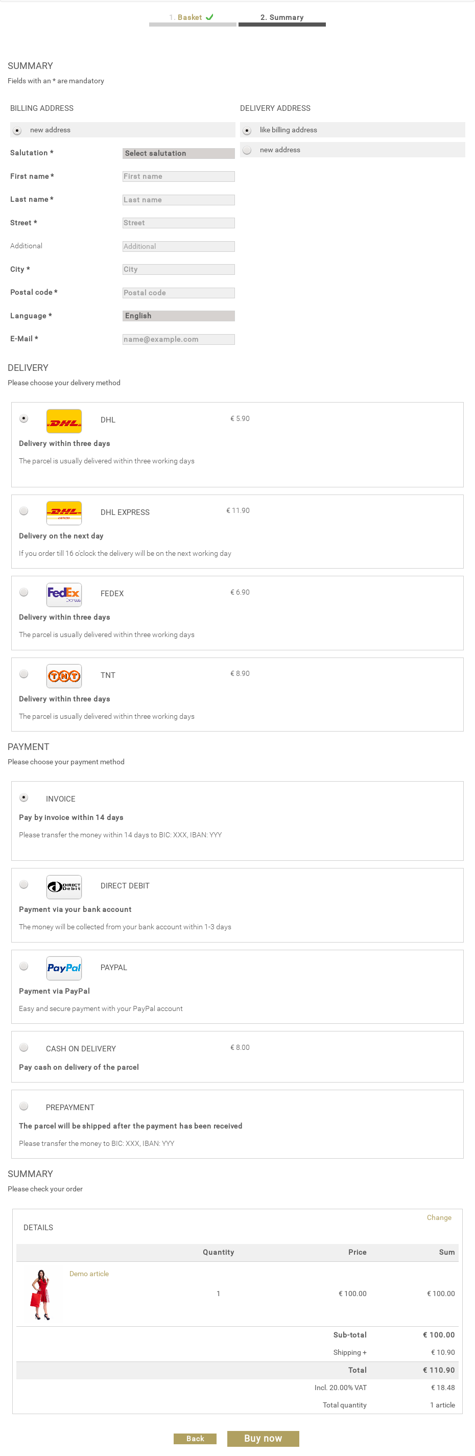

One page checkout#
You can decide to offer a one page checkout additionally to the standard multi step checkout or place two or more steps on the same checkout page. This makes the Aimeos checkout process incredibly flexible and allows you to adapt it to your needs.
The main configuration option for the one page checkout is client/html/checkout/onepage. Basically, it contains the checkout steps that should be placed on the same page. The available steps are those from the sub-clients of the checkout standard component:
- address
- delivery
- payment
- summary
There's a fifth ("process") step available but they aren't suited to be used for a one page checkout because they have to perform some actions after the order is placed. An example for a full one page configuration would be:
client/html/checkout/onepage = ['address', 'delivery', 'payment', 'summary']
The order of the subpart names doesn't matter in this setting as it's already determined by the order of the subparts configuration.
Commonly used variants are:
- Delivery and payment on one page
- This is used most often if you want to save one step for the customer and there are not much options to chose from on both pages. The downside of this combination is that you can't calculate additional payment costs based on the price of the chosen delivery option.
- Address, delivery and payment on one page
- A classic one page checkout that is legally safe because the summary is still the last step where customers have a complete overview of there data and the price to pay before they finish the order. Drawbacks are the limited payment cost calculation like in the first option and that delivery options can't be limited depending on the country or region of the customer.
- Full one page checkout including all steps
- This is the real all in one checkout where customers have every information on one page. It's best suited if you need to display only a limited amount of information or show/hide the parts where users have to enter their data dynamically. To be legally on the safe side, your total order amount must not change any more as soon as this page is displayed. This means that shipping costs are fixed and no payment costs can be charged. Additionally, all drawbacks of the last option applies as well.
When using a full one page checkout, you can limit the sections shown in the summary subpart as well. The blocks for the addresses and delivery/payment options are useless in this setup and should be removed from the checkout summary template.

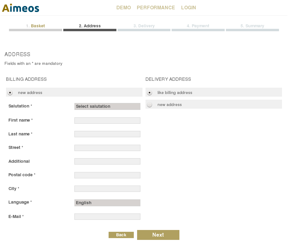

Address#
The address page in the checkout process is usually the first page during the checkout customers will see. If customers are already logged in and the Autofill basket plug-in is configured, the last address is added automatically to the basket.
Structure#
The address page consists of two sections: the billing address section; the delivery address section. These sections are controlled via the address subparts configuration. Both the billing and delivery sections can contain one or more custom subparts if you need to extend the existing implementations.
There are default implementations available for all sections but you are also able to replace or extend the existing implementations and configure alternative class names:
There can only be one billing address which is stored along with the user login data in the "mshop_customer" table if no other application specific table is used. For delivery addresses there's no limit and they are usually stored in the "mshop_customer_address" or in a table related to the user table of the application. Depending on your framework or application, their user tables are used instead of the "mshop_customer*" tables.
Form fields#
The shown fields in the billing and delivery forms are customizable. You can define each field as mandatory, optional or hidden. The values of hidden fields are sent along with the data entered by the customer but aren't shown in the front-end. All fields that are neither defined as mandatory, optional or hidden are not stored in the basket of the customer. The configuration options for the fields are:
- mandatory billing fields
- optional billing fields
- hidden billing fields
- mandatory delivery fields
- optional delivery fields
- hidden delivery fields
Tip
You can also prevent users from being able to enter a new billing or delivery address using these configuration options: * Disable new billing address * Disable new delivery address
The salutation drop-down contains the list of available salutation codes like "company", "mr" or "mrs" which are translated to appropriate strings in the language of the customer. You can customize which salutation codes can be chosen by the customer for the billing and delivery address.
There's a hidden input field for the birthday of the customer in the address form. As the birthday belongs to the customer account and not to the order address, you can't use the configuration settings listed before in this case. Instead, you can display it via CSS:
.aimeos .checkout-standard-address-billing .birthday {
display: block;
Templates#
To alter the billing address and delivery address sections, you can adapt the template for the address page by overwriting them in your own extension or by configuring alternative template names:
If you want to change the HTML structure of one of the templates, please have a look at the original versions to ensure that you don't lose essential functionality.
Validation#
Each field of the billing or delivery address form can be validated against a regular expression. This enables shop owners to define rules for each field and enforce syntax, like postal code patterns:
client/html/checkout/address/validate/postal = '/^[0-9]+$/'
Defined validation rules are applied to both, billing and delivery address fields.
Countries, regions and states#
When shipping to different countries, you need to know which country or region your customer is living or where the parcel should be shipped to. This may affect the shipping costs. Therefore, you should define the countryid field as mandatory in both the billing and delivery address. Afterwards, you can configure the countries or regions that will be available for selection by the customer:
client/html/checkout/address/countries = ['DE', 'FR', 'ES']
Usually, these are the two letter ISO country codes but you are able to choose any two letter code for describing e.g. a region like "EU" for Europe or "WE" and "EE" for western and eastern Europe.
Each country or region can be divided into states which is often used in the US. States are country or region specific so each list of states must belong to a country or region. Thus, the state list needs the country or region code as key:
client/html/checkout/address/states = array(
'US' => array(
'CA' => 'California',
'NY' => 'New York',

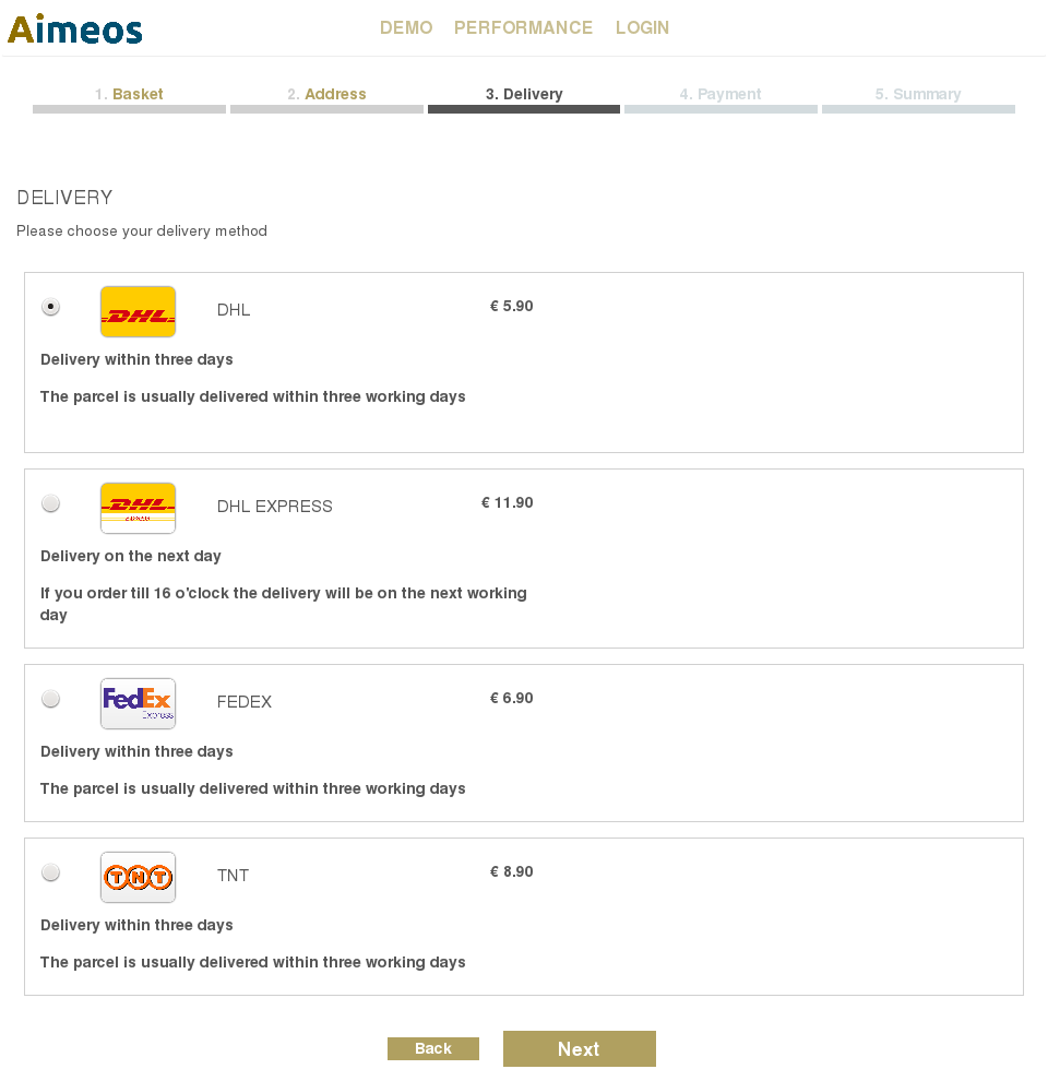

Delivery#
Currently, the implementation of the delivery step contains only one subpart for displaying the list of delivery options. Although, further subparts can be added like for any other component.
The list of delivery options is determined by the configured list of delivery services in the administration interface. All active delivery services from the current site and all parent sites are taken into account. Their order is determined by the "position" value of each service item and lower values are sorted before higher one.
You can adapt the body template for the delivery subpart by overwriting the template in your own extension or configuring an alternative template name:

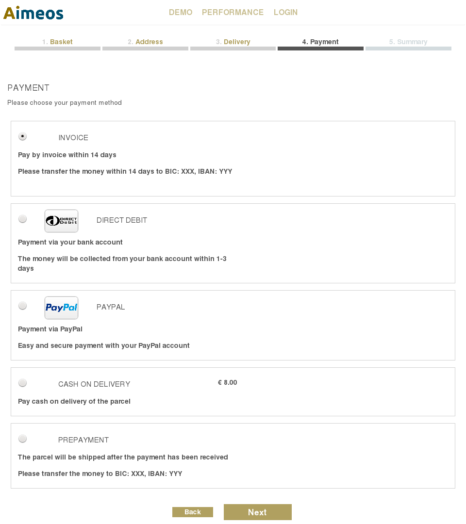

Payment#
Like in the delivery step, the implementation of the payment step also contains only one subpart, which can be extended as well.
All active payment services set up in the administration interface for the current site and all parent sites are listed on the payment page in the checkout process. The order of the payment items in the list of payment options is calculated in the same way as for the delivery step: The value of the "position" is used for sorting and those with lower values come first.
You can adapt the body template for the payment subpart by overwriting the template in your own extension or configuring an alternative template name:

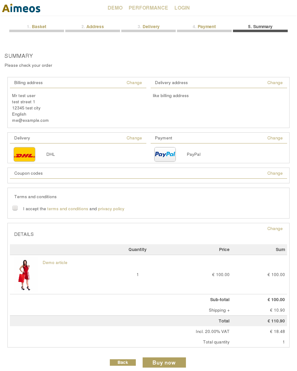

Summary#
Displaying the summary page is usually the last step before the order is stored into the database. It shows the complete basket content and some checkboxes, e.g. for terms and conditions, privacy policy, newsletter, etc.
Structure#
The checkout summary subpart contains no subparts itself but you can add one if needed by using checkout summary subparts. The summary template uses the "detail" partial shared with the basket and the HTML e-mails as well as a partial for the options.
Terms and privacy pages#
By default, the "options" partial contains a "terms" section where customers have to accept your terms and conditions and the privacy policy. Both need to link to the corresponding texts which must be available somewhere in your shop.
Templates#
You can adapt the template for the summary page by overwriting it in your own extension or configuring alternative template names:
Warning
Remember that the detail partial for the summary subpart is shared with the basket and e-mail components. If you change them, the layout for the basket, order history and e-mails will change as well if you don't configure to use a partial with a different name!

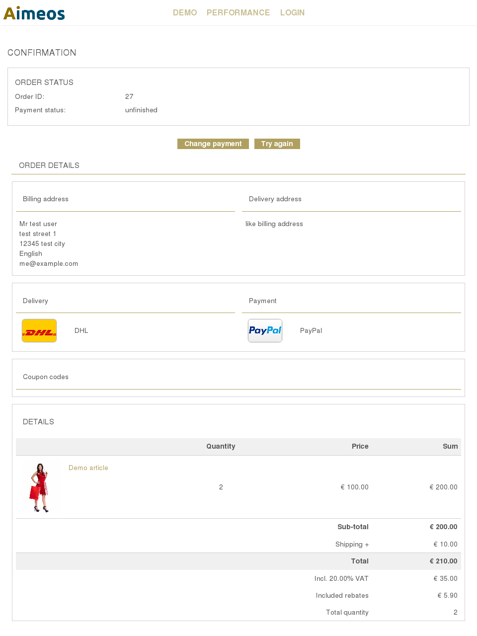

Confirm#
The "thank you" page including the "checkout confirm" component is the last page, the customers will be redirected to, either from the payment gateway or from the "checkout order" page.
Structure#
Two subparts are currently available in the "checkout confirm" component: The intro and order summary section.
The intro section contains only the headline and the notes for the customers that they will receive an e-mail with the order confirmation if the payment was successful resp. suitable texts for every payment status the order may have. You can change the texts via adapting their translations or add more subparts to the intro section.
At last, the order section summarizes the details of the order placed by the customer. It uses the same shared partials also shown in the order history or checkout summary.
