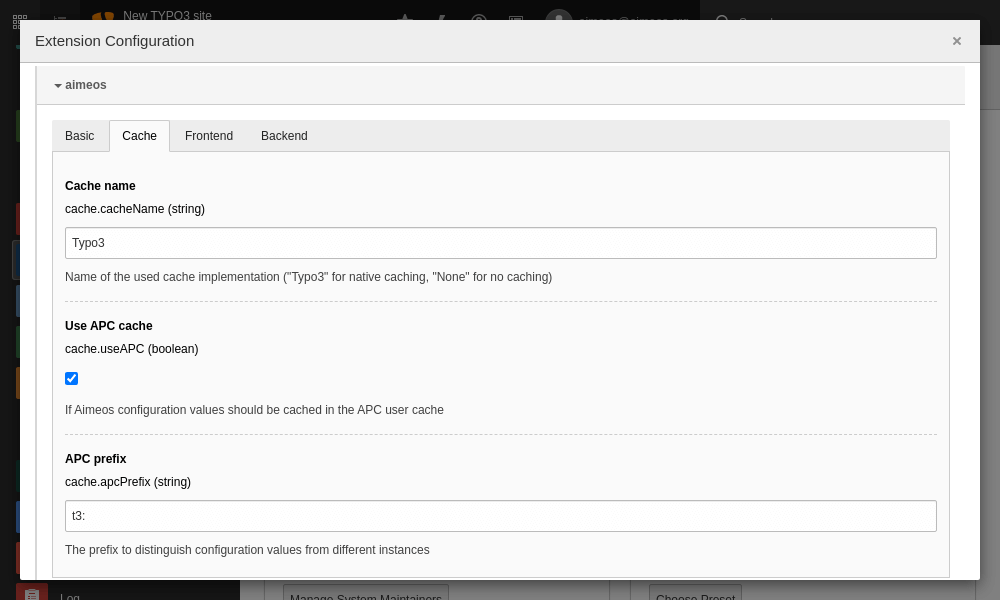

In order to tell your application to use the APC user cache, you need to activate the "Use APC cache" checkbox in the Aimeos extension configuration:
Enable APCu caching
Warning
If you have more than one shop application on the same server, you must assign an unique APC prefix for each instance!

To disable the content caching completely, change this setting in the Aimeos extension configuration:
Disable content caching
  • Admin Tools::Settings
  • Click on "aimeos"
  • Chose the "Cache" tab
  • Replace Typo3 in "Cache Name" with None
