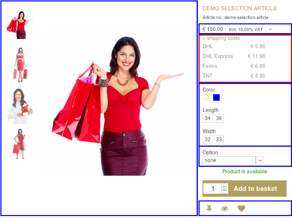

The existing components are located in the src/Client/Html/ directory and grouped together with similar components, e.g. the "Catalog" directory contains all components used for the product presentation, among others also the catalog detail component. Let's see what this component consists of:
As you can see, it contains some partials (blue) and one subpart (red). The locations of the subpart (and the partials too) depends on where you put them into your template, in this case the catalog/detail/body-standard template. The naming for the subpart class must correspond to the namespace and directory structure:
Aimeos\Client\Html\Catalog\Detail\Yourpart\Standard
You can rename "Yourpart" to whatever you like but it must consist of characters from a-z and digits from 0-9 only. Furthermore, the first character must be in upper case. The last part ("Standard" in this case) is the name of the implementation because there can be several ones with different code and functionality. The first implementation should be named Standard.
