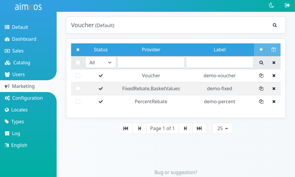

List of configured coupons#
The "Coupon" list view provides a paged list of all configured coupons in the system, which can be filtered by various criteria. The most important columns are shown by default but the list of columns can be adapted via the list header. Coupons can be added, edited or deleted either by using the shown buttons or by clicking on the list entry.

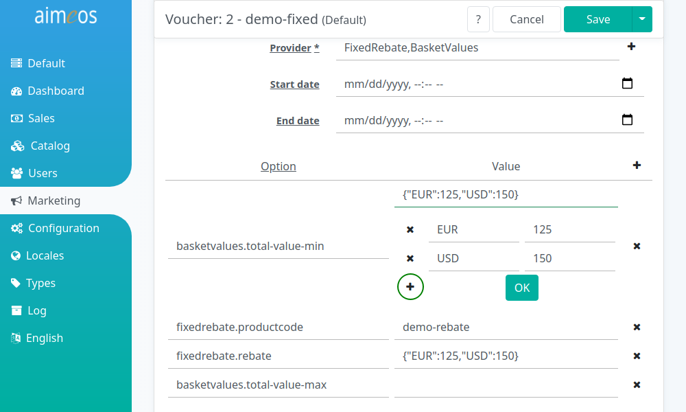

FixedRebate#
Adds a reduction product to the basket of the customer with the configured rebate amount. For example, if the configured rebate is {"EUR":"5.00"}, a value of 5€ would be subtracted from the basket total regardless of the total value of the basket. Therefore, in this case, it's a good idea to configure a minimum order value, that is higher than the granted rebate, as well.
- fixedrebate.productcode (required)
 - The unique code of the discount product that is used to show the granted rebate in the basket. As rebates are displayed like normal products, you can give them a descriptive name and add a picture in the same way as with a regular product. Caution: This is not the product the rebate should be for!
 - fixedrebate.rebate (required)
 - Rebate value in the currency the customers are using that should be granted if they enter a valid rebate code. The format of the value must be "x.xx" but the decimal point and two digits afterwards are optional. The value must not include a thousands separator or anything similar! It's possible to use different values for multiple currencies. To use 5.00 EUR and 7.00 USD insert {"EUR":5.00,"USD":7.00} as configuration value.
To enter value easily, click on the "+" icon to open an input dialog:
