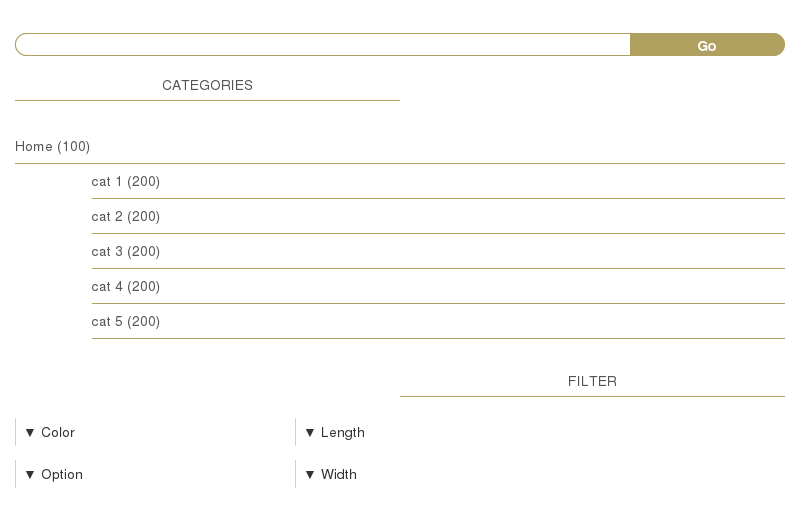

Filter#
When visitors are looking for products in the shop catalog, they need to utilize the catalog filter component. It offers possibilities to browse, search and filter products displayed in the Aimeos catalog list component.
Structure#
In the filter component implementation, at least three sections are available that can be controlled via the filter subpart configuration:
- attribute client
- the faceted search including the attribute subpart
- price client
- price filter including the price subpart
- search client
- full text search including the search subpart
- supplier client
- list of suppliers including the supplier subpart
- tree client
- category tree including the tree subpart
The catalog filter component itself has an additional configuration option for the search button that is normally displayed below the filter if Javascript is disabled. Via this setting, you can control if the button will be rendered or not.
For the tree subpart there are a few more options available, and they influence how the catalog tree is displayed:
- controller/frontend/catalog/levels-always
- Number of category levels that are always displayed
- controller/frontend/catalog/levels-only
- No more than this number of category levels will be visible
- client/html/catalog/filter/tree/startid
- Category ID to start with instead of the root category

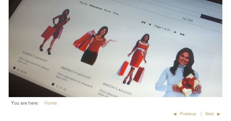

Stage#
Usually, the catalog stage component is placed over the product list and detail components. It can display category specific images and give users the ability to navigate between products and return to their previous product list.
Structure#
The stage component implementation also displays the back/next product links using the navigator template.
Furthermore, you can limit or extend the domain items that are fetched from the database and thus available in the templates via the client/html/catalog/stage/domains setting.

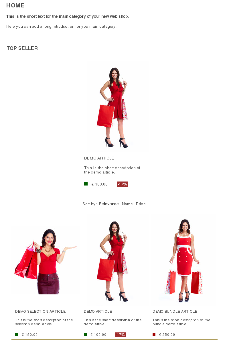

Lists#
Product lists are the backbone of every web shop, because they show visitors which products are available. In Aimeos, product lists are far more powerful than that. They can contain much more information like category texts/images, quotes, category top sellers and so on.
The list component implementation contains some settings that are used by more than one subpart:
- client/html/catalog/lists/catid-default
- If there's no category ID in the given parameters, this one is used to display products and the category information
- client/html/catalog/lists/domains
- A list of domain names whose items should be available in the product list view template. To add additional category or supplier data, use something like this:
For details please have a look at the documentation of the get() manager method
['text', 'media', 'price', 'catalog' => ['text', 'media'], 'supplier' => ['text']] - client/html/catalog/lists/size
- The maximum number of products shown in a list page before the result is paginated
- client/html/catalog/lists/stock
- Enables or disables displaying product stock levels in product list views
Other components such as the catalog filter need to know at which URL the product list will be displayed. The generated URL can be configured by these settings:
- URL target, e.g. page or route
- Controller name
- Controller action
- URL settings, e.g. for absolute URLs
Used templates for the list component are:
To those templates additional data like category information (texts, images), customer quotes (texts) is assigned. Store owners can attach these texts and images to categories that describe what products are listed in those categories and provide images as visual elements for that description.
The body template also uses a partial for rendering the pagination which contains not only the links for the product list paging itself but also the possibilities for sorting the result set.
Furthermore, the list component consists of two subparts. These are described in more detail below.
Main product list#
In the section implementing the product item list, the found products are displayed taking the given parameter and configuration settings into account. The items section use the options named in the list component description to configure the output of the product list.
Used template in the list items section is:
Promotional products#
Besides associating products as regular ones to categories, they can also be added as products that should be promoted. The difference is only the list type of the associated items. These products are then displayed in a special "top seller" section, which is provided by the list component implementation.
It's a short product list usually displayed on top of the list of regular products.
The promotional subpart itself can be additionally configured by the client/html/catalog/lists/promo/size option, that limits the number of promotional products displayed.
Used template in the promotional list section is:

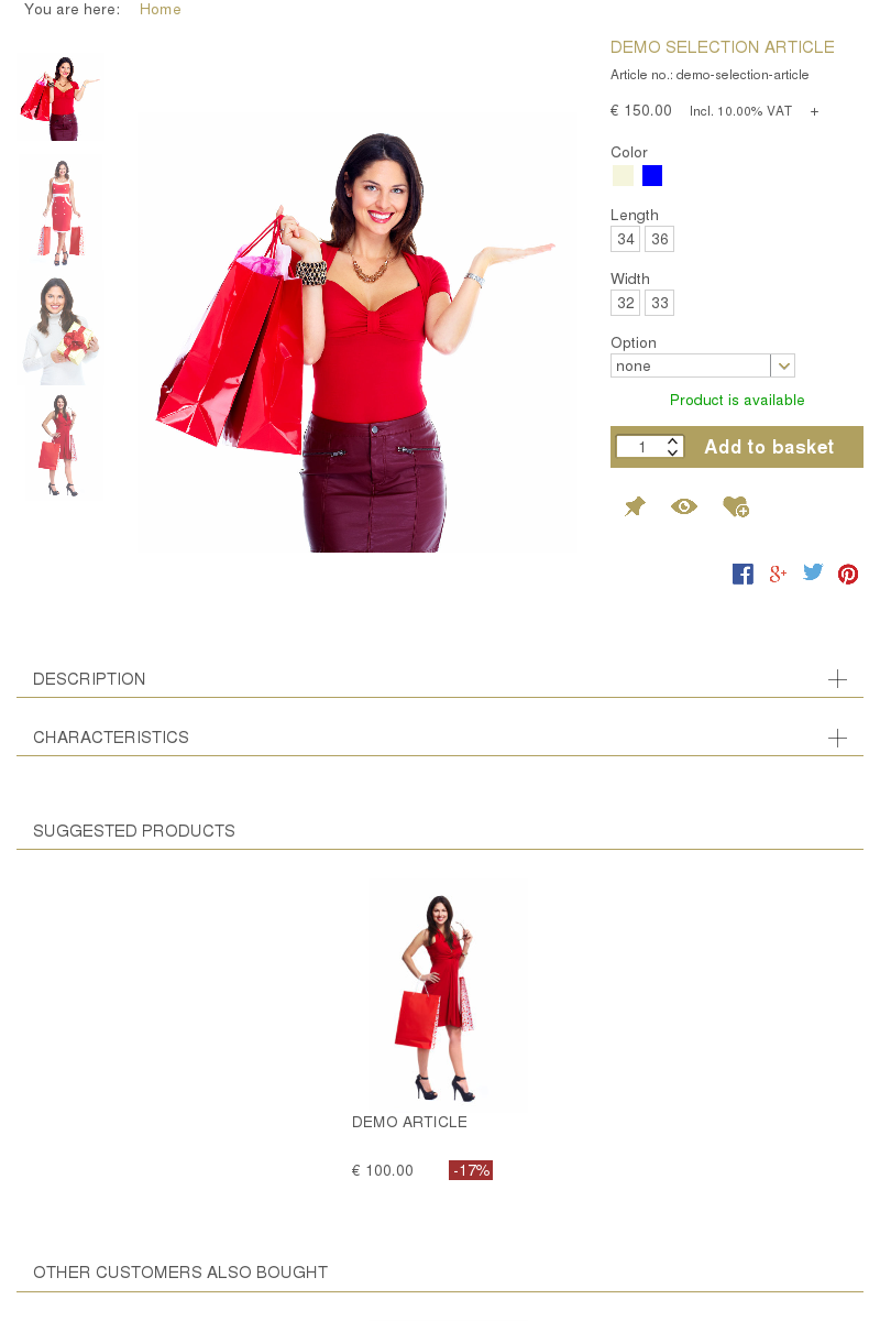

Detail#
The most important part of every web shop is the product detail page. It should inform the visitors about the product and convince them to buy it. The detail component of Aimeos consists of a whole bunch of sections that provide various types of information about the product which are described in this article.
In the detail component implementation there's a configuration option that is used by several subparts:
- client/html/catalog/detail/domains
- A list of domain names whose items should be available in the product detail view template. To add additional category or supplier data, use something like this:
['text', 'media', 'price', 'catalog' => ['text'], 'supplier' => ['text', 'media']]
Other components such as the catalog list need to know at which URL the product details will be displayed. The generated URL can be configured via these settings:
- Controller name
- Controller action
Used templates for the detail component are:
Furthermore, the detail component consists of two subparts (service and last seen). These are described in more detail below.
The image section displays the product's images and provides features such as a thumbnail list of all images and a light box, allowing the user to zoom-in and toggle the photo to full screen. This is implemented as a partial that is included in the body template.
Inside the basket related section is all the necessary information for choosing the product that is displayed and the required hidden data for adding the product to the basket. It's also responsible for displaying the price of the product (or of the selected sub-product) and the stock level information too. The selection of the product variant and optional attributes is outsourced in reusable partials.
The parameters and their format to add a product into the basket is described in the parameters section of the basket standard component
How customers can select the attributes for both types can be configured with the
client/html/catalog/selection/type/... = select|radio
client/html/catalog/attribute/type/... = select|input
configuration options. You only have to replace the three dots (...) with the attribute code used for the attribute types (length, width, color, size, etc.). Using "select" will display a HTML select box while "radio" will show a HTML radio checkbox for each option. The value "select" is the default for all attribute types if nothing else is configured.
You can also enforce if there's an option pre-selected or not using:
client/html/catalog/selection/preselect/... = 1
client/html/catalog/attribute/preselect/... = 1

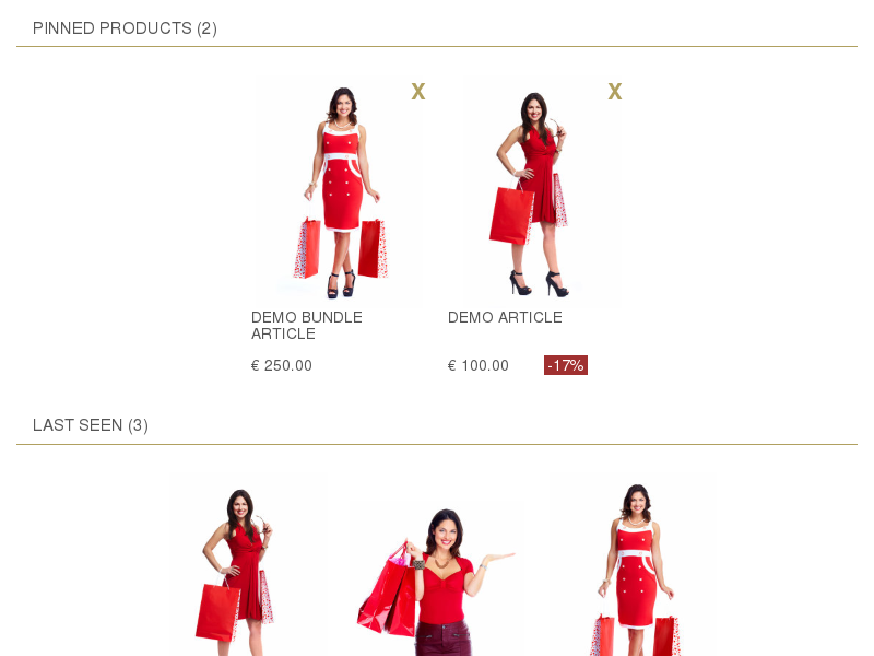

Session#
When visitors had a look at product details or if they pinned a product, this information is stored in the session of the visitor. The catalog session component displays this information and in the case of pinned products, visitors are also able to manage them.
Structure#
Two sections are part of the catalog session component implementation which can be controlled via the session subpart configuration:
- pinned client
- pinned products including the pinned subpart
- seen client
- the last seen products including the seen subpart
Both subparts allow further configuration, namely for the entry count in the header and the maximum number of allowed items in both lists:
- client/html/catalog/session/pinned/domains
- A list of domains whose items should be fetched from the database for the product representation in the pinned view
- client/html/catalog/session/pinned/count/enable
- Display the number of entries in the "pinned" list next to the section header
- client/html/catalog/session/pinned/maxitems
- Maximum number of displayed pinned products
- client/html/catalog/session/seen/count/enable
- Display the number of entries in the "last seen" list next to the section header
- client/html/catalog/session/seen/maxitems
- Maximum number of displayed "last seen" products
Templates#
You can adapt the templates for the catalog filter component and their subparts by overwriting the templates in your own extension or configuring alternative template names:
- template body for the session component
- template header for the session component
- template body for the pinned products list
- template body for the "last seen" products list

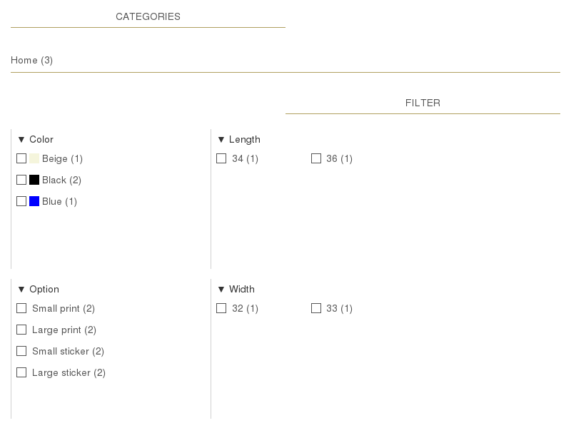

For the faceted search, the product counts should be displayed right to the categories and filter attributes. These numbers are returned by a separate request and inserted into the page by the delivered Javascript code.
Structure#
The catalog count component implementation contains at least two sections that can be controlled via the count subpart configuration:
- attribute client
- attribute based faceted search including the attribute subpart
- supplier client
- supplier numbers including the supplier subpart
- tree client
- category numbers including the tree subpart
In the catalog count component itself you can configure if the numbers should be calculated at all:
- client/html/catalog/count/enable
- Enables or disables displaying product counts in the catalog filter
Additionally, the attribute and tree subparts can be configured separately to show the product counts or not:
- client/html/catalog/count/attribute/aggregate
- Enables or disables generating product counts for the attribute catalog filter
- client/html/catalog/count/supplier/aggregate
- Enables or disables generating product counts for the supplier catalog filter
- client/html/catalog/count/tree/aggregate
- Enables or disables generating product counts for the category catalog filter
To load the product counts, the URL of the catalog count component must be known and required URL is generated based on these settings:
- Controller name
- Controller action

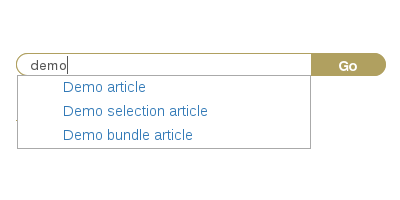

Suggest#
When visitors use the catalog search filter to find products via a full text search, a list of product names is displayed whose content contains the entered words. This is also known as "auto completion" or "suggestion".
Structure#
The suggest component implementation consists only of the component itself.
To display the list of suggestions, the URL for fetching the found product names must be available. The generated URL can be configured via these settings:
- Controller name
- Controller action
