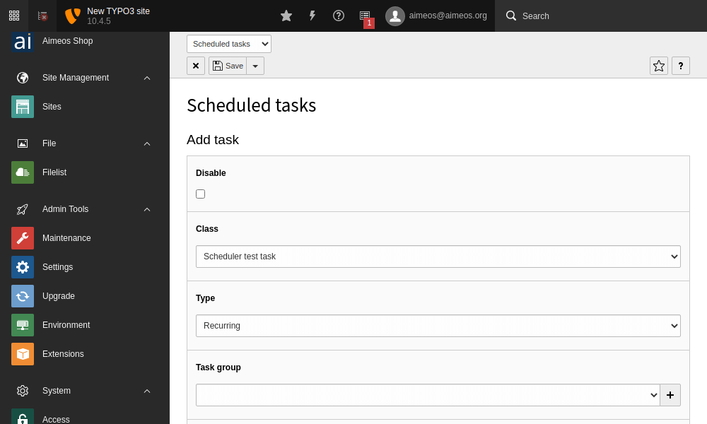

Create Aimeos tasks#
After installing the Aimeos TYPO3 extension, a new scheduler task named "Aimeos scheduler" is available. It's capable of executing one or more Aimeos jobs for one or more sites. Normally, you will need to add the Aimeos scheduler task several times with different jobs. To add a new task, click on the icon with the plus symbol (green one in the upper left corner / above the list of configured tasks):
Configure a task for them by
- click on the plus sign above the list of configured tasks
 - new window Scheduled tasks opens:
- Select "Aimeos Shop advanced scheduler"
 - set selection box Type to value "Recurring"
 - enter e.g. " * * * " in field Frequency to run the task every minute
 - configure the additional fields like page IDs if applicable
 - select the jobs (see below for details)
 - select the sites for which the jobs will be executed (at least "default")
 - click Save and close.
