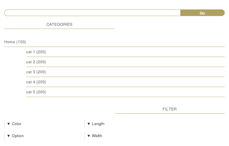

Filter#
When visitors are looking for products in the shop catalog, they need to utilize the catalog filter component. It offers possibilities to browse, search and filter products displayed in the Aimeos catalog list component.

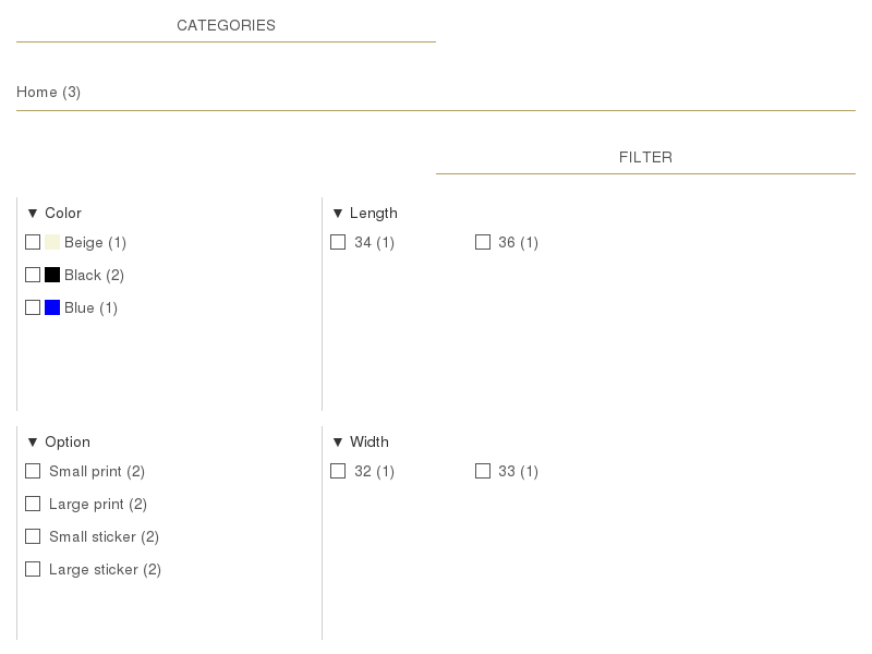

Structure#
Aimeos catalog filter
In the filter component implementation, at least three sections are available that can be controlled via the filter subpart configuration:
attribute client
the faceted search including the attribute subpart
price client
price filter including the price subpart
search client
full text search including the search subpart
supplier client
list of suppliers including the supplier subpart
tree client
category tree including the tree subpart
The catalog filter component itself has an additional configuration option for the search button that is normally displayed below the filter if Javascript is disabled. Via this setting, you can control if the button will be rendered or not.
For the tree subpart there are a few more options available, and they influence how the catalog tree is displayed:
controller/frontend/catalog/levels-always
Number of category levels that are always displayed
controller/frontend/catalog/levels-only
No more than this number of category levels will be visible
client/html/catalog/filter/tree/startid
Category ID to start with instead of the root category

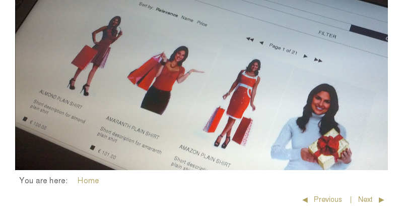

Stage#
Usually, the catalog stage component is placed over the product list and detail components. It can display category specific images and give users the ability to navigate between products and return to their previous product list.
Structure#
Aimeos catalog stage
In the stage component implementation, one additional section is available that can be controlled via the stage subpart configuration:
navigator client
back/next product links inluding the navigator subpart
Furthermore, you can limit or extend the domain items that are fetched from the database and thus available in the templates via the client/html/catalog/stage/domains setting.
Templates#
You can adapt the templates for the catalog stage component and their subparts by overwriting the templates in you own extension or configuring alternative template names:

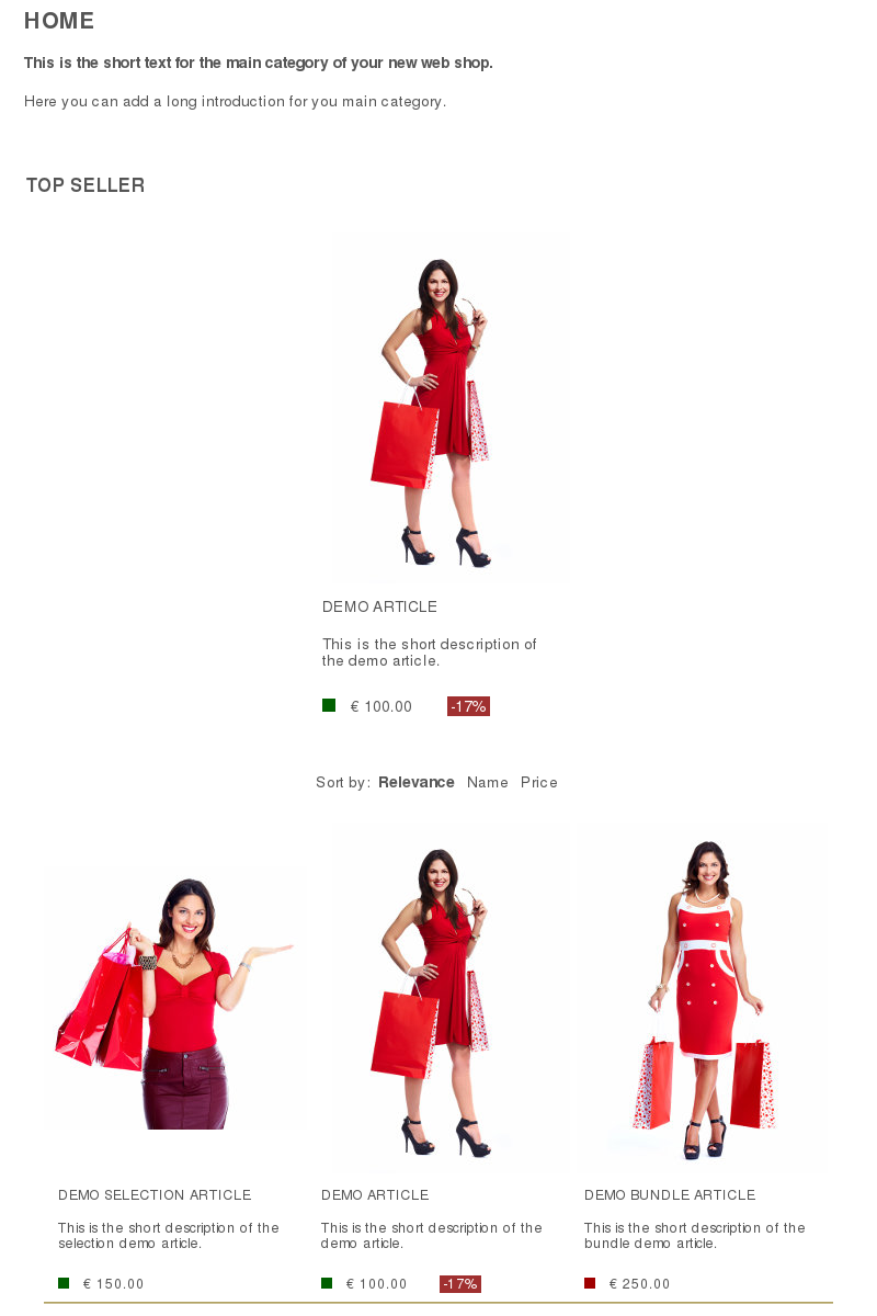

Lists#
Product lists are the backbone of every web shop, because they show visitors which products are available. In Aimeos, product lists are far more powerful than that. They can contain much more information like category texts/images, quotes, category top sellers and so on.
Aimeos catalog list
The list component implementation contains some settings that are used by more than one subpart:
client/html/catalog/lists/catid-default
If there's no category ID in the given parameters, this one is used to display products and the category information
client/html/catalog/lists/domains
A list of domain names whose items should be available in the product list view template. To add additional category or supplier data, use something like this:
['text', 'media', 'price', 'catalog' => ['text', 'media'], 'supplier' => ['text']]
For details please have a look at the documentation of the get() manager method
client/html/catalog/lists/size
The maximum number of products shown in a list page before the result is paginated
client/html/catalog/lists/stock/enable
Enables or disables displaying product stock levels in product list views
Other components such as the catalog filter need to know at which URL the product list will be displayed. The generated URL can be configured by these settings:
Used templates for the list component are:
To those templates additional data like category information (texts, images), customer quotes (texts) is assigned. Store owners can attach these texts and images to categories that describe what products are listed in those categories and provide images as visual elements for that description.
The body template also uses a partial for rendering the pagination which contains not only the links for the product list paging itself but also the possibilities for sorting the result set.
Furthermore, the list component consists of two subparts that can be controlled by the list subparts configuration. These are described in more detail below.
Main product list#
In the section implementing the product item list, the found products are displayed taking the given parameter and configuration settings into account. More subparts can be added via the list subparts setting. The items section use the options named in the list component description to configure the output of the product list.
Used template in the list items section is:

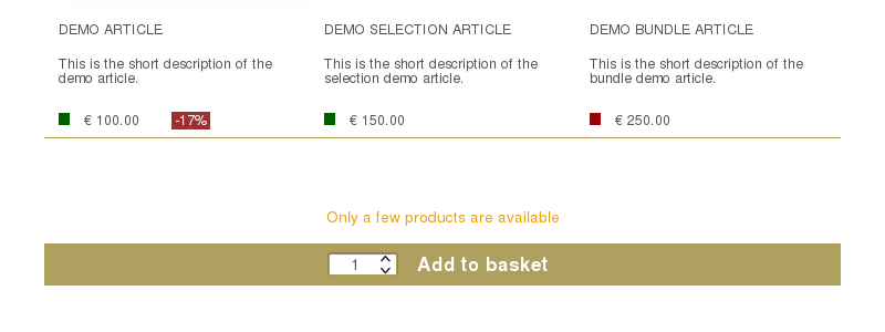

Promotional products#
Besides associating products as regular ones to categories, they can also be added as products that should be promoted. The difference is only the list type of the associated items. These products are then displayed in a special "top seller" section, which is provided by the promo section implementation.
It's a short product list usually displayed on top of the list of regular products and if more features are necessary, they can be implemented by further subparts controlled by the promo subparts setting.
The promotional subpart itself can be additionally configured by the client/html/catalog/lists/promo/size option, that limits the number of promotional products displayed.
Used template in the promotional list section is:

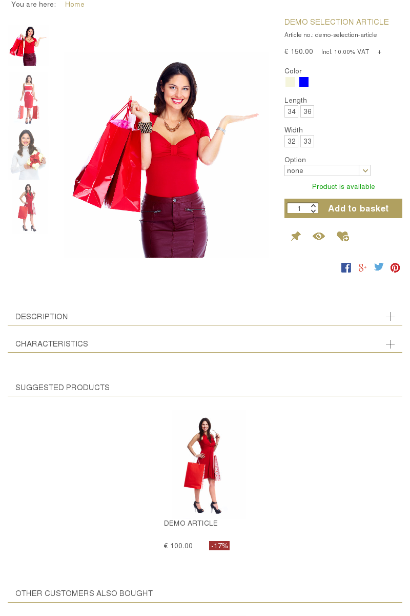

Detail#
The most important part of every web shop is the product detail page. It should inform the visitors about the product and convince them to buy it. The detail component of Aimeos consists of a whole bunch of sections that provide various types of information about the product which are described in this article.
Aimeos catalog detail
In the detail component implementation there's a configuration option that is used by several subparts:
client/html/catalog/detail/domains
A list of domain names whose items should be available in the product detail view template. To add additional category or supplier data, use something like this:
['text', 'media', 'price', 'catalog' => ['text'], 'supplier' => ['text', 'media']]
Other components such as the catalog list need to know at which URL the product details will be displayed. The generated URL can be configured via these settings:
Used templates for the detail component are:
Furthermore, the detail component consists of two subparts (service and last seen) that can be controlled via the detail subpart configuration. These are described in more detail below.
The image section displays the product's images and provides features such as a thumbnail list of all images and a light box, allowing the user to zoom-in and toggle the photo to full screen. This is implemented as a partial that is included in the body template.
Inside the basket related section is all the necessary information for choosing the product that is displayed and the required hidden data for adding the product to the basket. It's also responsible for displaying the price of the product (or of the selected sub-product) and the stock level information too. The selection of the product variant and optional attributes is outsourced in reusable partials.
The parameters and their format to add a product into the basket is described in the parameters section of the basket standard component
How customers can select the attributes for both types can be configured with the
client/html/catalog/selection/type/... = select|radio
and
client/html/catalog/attribute/type/... = select|input
configuration options. You only have to replace the three dots (...) with the attribute code used for the attribute types (length, width, color, size, etc.). Using "select" will display a HTML select box while "radio" will show a HTML radio checkbox for each option. The value "select" is the default for all attribute types if nothing else is configured.
You can also enforce if there's an option pre-selected or not using:
client/html/catalog/selection/preselect/... = 1
client/html/catalog/attribute/preselect/... = 1
Services#
The delivery option listing is implemented as subpart because it has to fetch additional, non-product related information from the database. More service subparts can be added to the service implementation if necessary.
Only the body template is used by the service section:
Bundled products#
If the shown product is of type "bundle", the bundled products are displayed as well. For this, the product partial is used.
User actions#
The user actions are links to features where customers can add a product to one of their lists of pinned, favorite or watched products. Which user actions are shown is controlled by the client/html/catalog/actions/list setting. They, as well as the social media buttons are both included by using partials.
There are several social platforms that can help to boost the sales of web shops, namely Pinterest, Facebook, WhatsApp and Twitter. They enable visitors to add products to their time line or social media profile.
Via the configuration option for the displayed list of social links, you can choose which ones are available for your visitors. You can also add new social media links without changing the code. With the social list setting it's possible to add new or remove existing social links, which are then defined by the
client/html/catalog/social/url/... = https://...
settings. Replace the three dots (...) by the name you've used in the social list configuration and insert the link for sharing your product links as value. Links to these social media platforms are available by default:
Additional information#
Another big block in the catalog detail component is the additional content. Here you can add all product content you might show your visitors for your products. This contains:
  • Any text information about the product
  • Shared product attributes like color or size
  • Non-shared product properties like weight or dimensions
  • Product related documents to download, e.g. reference manuals
The difference between product attributes and properties is in the way they are managed. Product attributes are shared and can be associated to many products while properties are only stored for one product. If you change an attribute, all products referencing the same will show the new content immediately while for properties this isn't the case.
Suggested products#
For each product, shop owners can offer a list of suggested products that are shown in their own section,. It can contain an arbitrary number of products (if zero, the section won't be displayed) but should only contain the few most important ones.
Bought by others#
When the job controller for generating the list of products bought together with the one displayed in the detail view runs regularly, this section will contain the appropriate products.

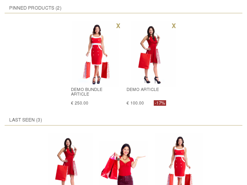

Session#
When visitors had a look at product details or if they pinned a product, this information is stored in the session of the visitor. The catalog session component displays this information and in the case of pinned products, visitors are also able to manage them.
Structure#
Aimeos catalog session
Two sections are part of the catalog session component implementation which can be controlled via the session subpart configuration:
pinned client
pinned products including the pinned subpart
seen client
the last seen products including the seen subpart
Both subparts allow further configuration, namely for the entry count in the header and the maximum number of allowed items in both lists:
client/html/catalog/session/pinned/domains
A list of domains whose items should be fetched from the database for the product representation in the pinned view
client/html/catalog/session/pinned/count/enable
Display the number of entries in the "pinned" list next to the section header
client/html/catalog/session/pinned/maxitems
Maximum number of displayed pinned products
client/html/catalog/session/seen/count/enable
Display the number of entries in the "last seen" list next to the section header
client/html/catalog/session/seen/maxitems
Maximum number of displayed "last seen" products

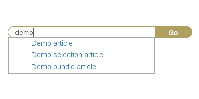

Suggest#
When visitors use the catalog search filter to find products via a full text search, a list of product names is displayed whose content contains the entered words. This is also known as "auto completion" or "suggestion".
Structure#
Aimeos catalog suggest
The suggest component implementation consists only of the component itself, but you can add additional section via the suggest subpart configuration.
To display the list of suggestions, the URL for fetching the found product names must be available. The generated URL can be configured via these settings:
Templates#
You can adapt the templates for the catalog suggest component by overwriting the templates in your own extension or configuring alternative template names:
