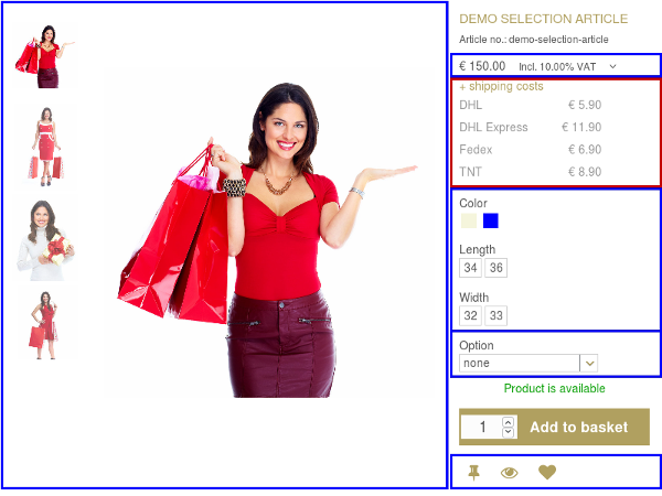

Catalog detail subparts
As you can see, it contains some partials (blue) and one subpart (red). The locations of the subpart (and the partials too) depends on where you put them into your template, in this case the catalog/detail/body-standard template. The naming for the subpart class must correspond to the namespace and directory structure:
Aimeos\Client\Html\Catalog\Detail\Yourpart\Standard
You can rename "Yourpart" to whatever you like but it must consist of characters from a-z and digits from 0-9 only. Furthermore, the first character must be in upper case. The last part ("Standard" in this case) is the name of the implementation because there can be several ones with different code and functionality. The first implementation should be named Standard.
