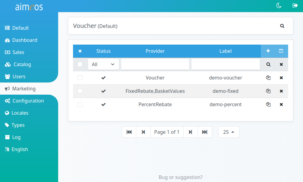

List of configured coupons#
The "Coupon" list view provides a paged list of all configured coupons in the system, which can be filtered by various criteria. The most important columns are shown by default but the list of columns can be adapted via the list header. Coupons can be added, edited or deleted either by using the shown buttons or by clicking on the list entry.
