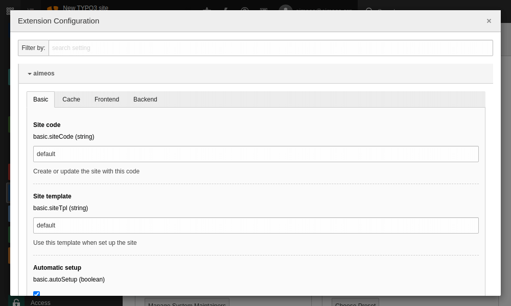

  2. Create the new site in the Extension Manager#
    In the Extension Manager, go to the Aimeos configuration settings. Enter a new "site code" for which a new site will be created. (If it already exists, it will be updated with the required entries for the used extension version, in case you have updated to a newer Aimeos version.)
    Aimeos extension settings
    • Admin Tools::Settings:
      1. Search for "aimeos"
      2. Enter a new site code in the corresponding input field
      3. Save and return
    • Admin Tools::Extensions:
      1. Click on the update icon of the Aimeos extension
    The "update" function runs through a list of checks. Once this check has finished executing, you'll be presented with the types of data that have been added to the new site.

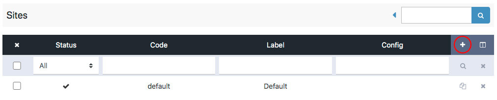

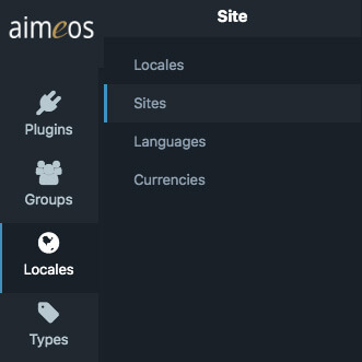

    In the Aimeos administraion interface of the TYPO3 backend, open the "Locales" menu and click on "Sites":
    Aimeos Locales :: Site
    Add a new site:
    Add a new *Aimeos* site

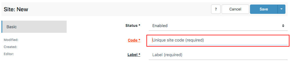

    Enter the new "site code" in the required "Code" field:
    Finally click "Save" in the upper right corner.

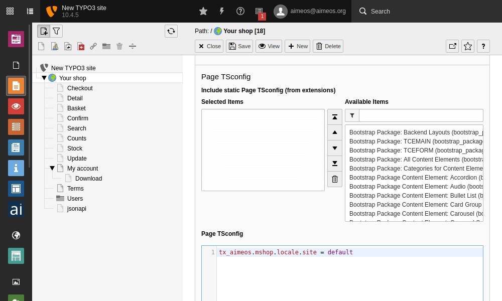

  4. Add pageTS config#
    Back in TYPO3's page tree, go to the root page of the newly created shop/site. In order to display the appropriate data of the respective (second, third,...) shop/site, add an additional setting to the page's pageTS field:
    PageTS for multiple sites
    • Web::Page
      1. Select the root site of the new page tree
      2. Edit page
      3. Tab Resources, section TypoScript Configuration
    tx_aimeos.mshop.locale.site = <code of site>
    Click on the icon for Save and close document at the top to store the change. Repeat these steps for each page tree where an different shop site other than the "default" site should be used. Clear all TYPO3 caches when you are done.

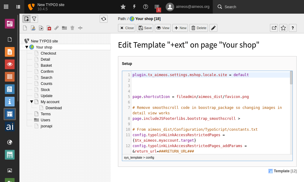

  5. TypoScript config#
    To tell the frontend which shop/site to use in the new site's page tree, add a line of TypoScript to the setup configuration:
    Aimeos setup TS configuration
    • Web::Template
      1. Select the new site's page tree root
      2. Choose Info/Modify in the drop-down at the top
      3. Click on Setup in the box below
    plugin.tx_aimeos.settings.mshop.locale.site = <code of site>

    Users can switch between multiple shops if the loc-site parameter is included in the URL. You can configure the name of the parameter (loc-site by default) to a different name in the TypoScript setup section:
    plugin.tx_aimeos.settings.typo3.param.name.site = <name of the site parameter>
    For example, if you use the parameter "C" for the countries and that matches the site code, too, then you have to add this configuration to your TypoScript setup:
    plugin.tx_aimeos.settings.typo3.param.name.site = C

    In order to get the code of a specific shop/site, go to "Aimeos Locales", choose "Sites" from its submenu and then one of the shops. You will find the site's unique code in the required field "Code". (Please have a look at step 3 for details on how to get to the Aimeos Locales and its site settings.)
    Next, enter the code in the Aimeos extension settings and run the update script. (Please have a look at step 2 for a detailed description on how to get to the Aimeos extension settings.)
    Repeat these steps for every shop you administer.
